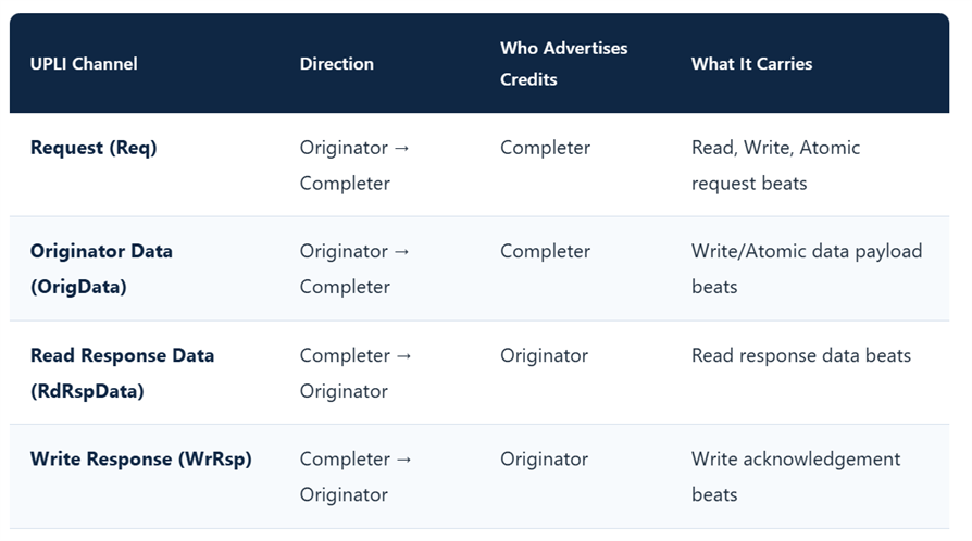

Four Lanes, Four Kitchens—The UPLI Channel Model
Here is where UALink gets cleverly engineered. There is not one credit pool, there are four independent credit loops, one per UPLI channel. Think of it like a restaurant with four entirely separate kitchens: one for appetizers, one for mains, one for desserts, and one for drinks. If the dessert kitchen is overwhelmed, your steak still arrives on time.
Each channel manages its own credits independently. Backpressure on write responses never stalls read requests. A slow-to-respond completer filling up the RdRspData channel cannot block new requests from flowing in on the Req channel. This isolation is not an accident - it is the architectural backbone that prevents head-of-line blocking in complex multi-accelerator workloads.

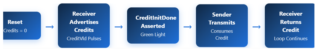

The Credit Lifecycle—From Reset to Steady State
Every time a UPLI interface comes up from reset, the credit mechanism goes through a precise, four-phase lifecycle. Miss any phase, and the protocol breaks before a single byte of data moves.
1. Reset—Zero Credits, Clean Slate
After reset, the sender starts with exactly zero credits on all channels and all VCs. No transmission is allowed. The receiver prepares its buffers and gets ready to advertise initial credit availability. The protocol is in a known, safe starting state.
2 Credit Advertisement—The Receiver Opens the Gates
The receiver begins releasing initial credits by pulsing its CreditVld signals. Each valid pulse carries 1-4 credits (encoded as value+1 on CreditNum signals). The Receiver advertises credits for VC slots, Pool slots, or both - at its own pace, in any order the implementation chooses. The sender accumulates these credits into its counters but does not yet transmit.
3 CreditInitDone—The Green Light
Once the receiver has advertised all initial credits for a channel/port, it asserts CreditInitDone. This signal means: "I have told you everything I have. You are now cleared to transmit." CreditInitDone must remain asserted until the next reset—it is a one-way gate. The sender waits for CreditInitDone to be stable for an implementation-defined number of cycles before it starts transmitting.
4 Steady State—Consume, Return, Repeat
With CreditInitDone asserted, the credit loop enters the continuous steady-state rhythm: the sender consumes one credit per beat it transmits; the receiver processes beats and returns credits by pulsing CreditVld again - replaying the exact VC and Pool type it recorded when the beat originally arrived. The sender replenishes its counter and can transmit again. This loop runs indefinitely until the next reset.

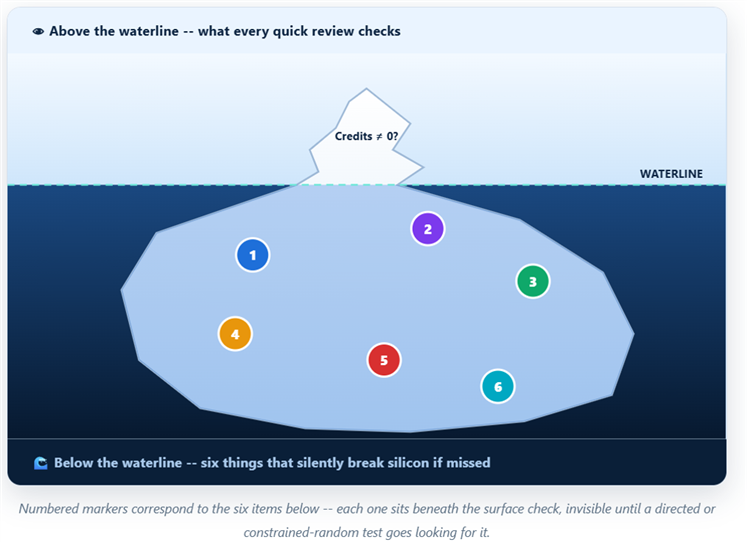

The Verification Iceberg—6 Things That Must All Be Right

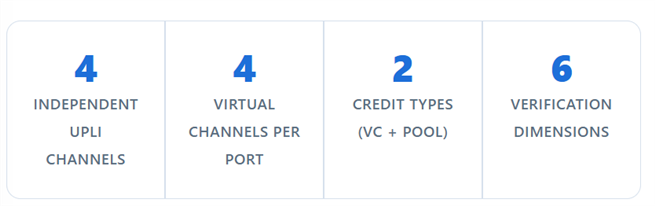

UPLI credit verification spans four channels × four ports × four virtual channels × two credit types - all operating concurrently. The visible tip of the iceberg is "make sure credits are not zero before sending." Here is what else matters most.
  1. Credit initialization correctness: The receiver must release exactly the configured number of VC and Pool credits after reset, and CreditInitDone must assert only after the last credit lands.
  2. No transmission without credits: The golden rule: the sender must never send a beat when the corresponding credit count is zero, even under concurrent multi-VC traffic with delayed returns.
  3. Overflow and return fidelity: Returned credits must never exceed the configured buffer depth, and each return must replay the exact VC/Pool type recorded on the original beat. A mismatch corrupts counters silently.
  4. Multi-channel write coordination: Write operations need credits on both Req and OrigData channels simultaneously, with the first data beat contiguous to the request. This is a non-trivial pre-check under congestion.
  5. Credit exhaustion and recovery: Fully exhaust all credits on a channel. The sender must stall cleanly, then resume seamlessly once credits are returned, with no dropped or duplicate beats.
  6. No beat before handshake: CreditInitDone must be asserted on all required channels before the first UPLI beat is ever sent. A premature beat is an uncatchable data loss.
