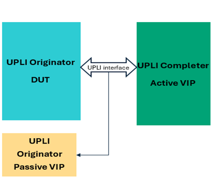

    1. DUT originator and VIP completer: In this topology the DUT is responsible for initiating transactions by issuing request messages such as reads, writes, or atomic operations. The verification focuses on ensuring the DUT correctly forms these requests, manages transaction tags for multiple outstanding transactions, and properly processes the corresponding responses returned by the VIP. The VIP acts as a target device that can respond to requests. Passive originator VIP agent receives and validates the format and legality of the Requests from the DUT. As a completer, the VIP must generate and transmit a valid response for every request it receives, as all requests require a response. The VIP can be configured to control responses and their timing to test the DUT's ability to handle many outstanding transactions.

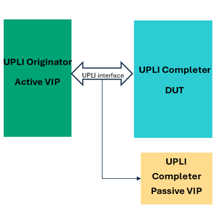

    2. VIP originator and DUT completer: The VIP generates a wide range of legal requests (commands) and sends them to the DUT. The VIP can create complex scenarios with multiple outstanding transactions using different transaction tags to stress the DUT's processing capabilities. After issuing requests, the passive VIP agent monitors and validates the responses from the DUT. The DUT must be able to receive and process incoming requests from the VIP. Verification focuses on the DUT's ability to correctly parse different command types, perform the requested memory operations, and generate and send back a valid, properly tagged Response for each transaction.

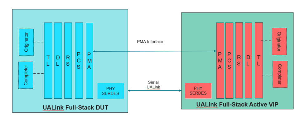

2. Full stack DUT with UPLI: This full-stack topology enables users to verify the entire UALink protocol stack, from the UPLI layer down to the physical layer, in a realistic and integrated environment. It ensures that end-to-end data integrity is maintained across the complete communication path, which is critical for validating correctness in real-world scenarios. By including both the originator and completer roles on both DUT and VIP sides, this setup allows for bi-directional traffic, simulating actual system behavior. Additionally, it helps verify real-time path delays, buffering behavior, and flow control across intermediate layers such as the transport, data link, and physical layers. These intermediate layers play a crucial role in flit conversion, CRC/FEC handling, and serialization, all of which must be validated to ensure protocol compliance and performance.
