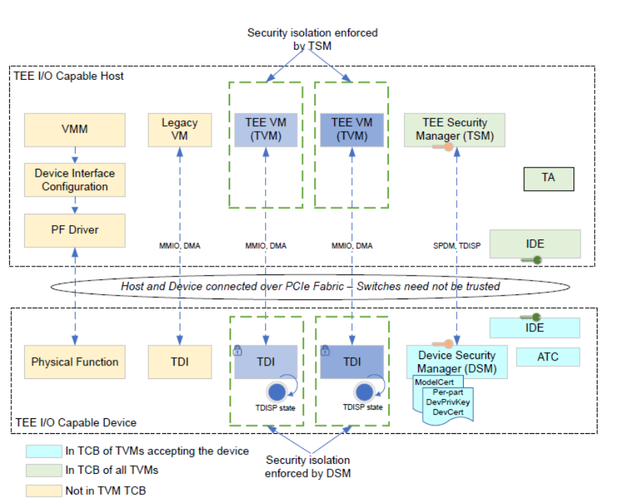

The TEE Device Interface Security Protocol (TDISP) is a critical component in ensuring the Interface security of devices operating within a Trusted Execution Environment (TEE). It gives a set of rules designed to prevent and mitigate security threats in devices managed by a Trusted Computing Base (TCB). The TCB, comprising software, hardware, and firmware, enforces these security rules to ensure system integrity. Acting as the upper layer of security, TDISP serves as a guardian layer for Integrity and Data Encryption (IDE). This blog provides an overview of TDISP, its requirements, setup, and the challenges faced during its verification.
Key Components
  • Trusted Execution Environment (TEE): A secure area within a device where operations are considered trustworthy.
  • TEE Virtual Machine (TVM): A virtual machine within the TEE.
  • TEE Security Manager (TSM): Manages security rules on the host.
  • TEE Device Interface (TDI): Managed by the TVM, it can be an entire device or a specific function.
  • Device Security Manager (DSM): Manages security rules on the device.
  • VMM (Virtual Machine Monitor): Manages virtual machines.
  • Legacy VM: A standard virtual machine without TEE capabilities.
  • Device Interface Configuration: Manages how devices are exposed to VMs.
  • PF Driver (Physical Function Driver): Interfaces with the physical device.
Figure1: TDISP Components
Figure 1: TDISP architecture with example host and device and logical communication paths

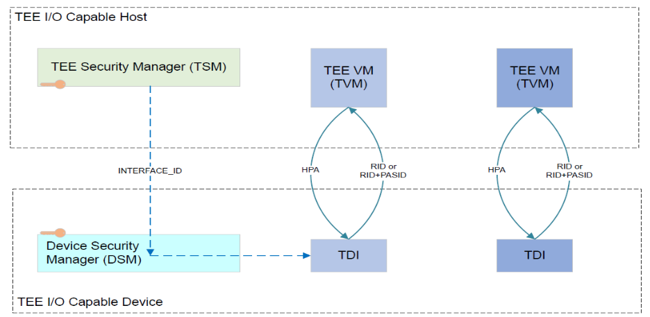

How TDISP Protects Against Attacks
TDISP is designed to safeguard PCIe devices operating within a TEE by addressing multiple vectors of potential attacks. It ensures device authenticity and integrity through cryptographic verification using the CMA/SPDM protocol, which helps prevent tampering with critical identifiers like Vendor ID and Device ID. To secure communication between the device and host, TDISP leverages IDE, protecting data from physical interception or manipulation. It also enforces strict control over TDI management, mitigating risks associated with unauthorized changes to DMA and interrupt remapping tables. Furthermore, TDISP isolates sensitive data and enforces access control to prevent physical functions from influencing the security properties of virtual machines. Through these layered defenses, TDISP establishes a robust framework for protecting PCIe devices in secure computing environments.
