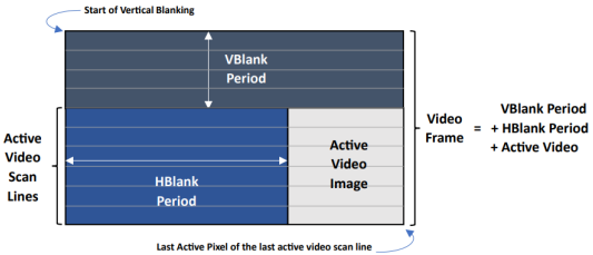

During both the operations, the VTotal is changed to indirectly increase/decrease the refresh rate. As the refresh rate is inversely proportional to frame duration, the increase in VTotal/Frame duration decreases the refresh rate and the decrease in VTotal/Frame duration increases the refresh rate. The VTotal is nothing but a summation of blanking lines and active lines (refer Figure – 2.). The active lines are the ones that contain the actual pixel information that will be used to create the image that will be displayed on the screen and the blanking lines are used to share additional information (such as Secondary Data Packets, Mainstream Attributes, etc.) that are related to a frame.
Figure 2: Pictorial representation of Video Frame and Active Video Image
