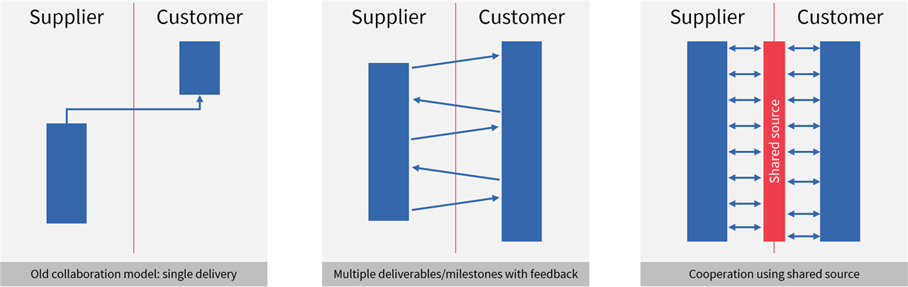

Collaboration
One thing that is clear is that SDV will require much closer collaboration between suppliers and customers. Where traditionally companies would buy a complete point solution for a specific function or subsystem as a physically installable unit, with SDV, the emphasis shifts to software and its deployment on shared physical computers. This changes how deliveries and deliverables are handled—moving towards something much more like traditional IT.
SDV also requires faster collaboration. In a traditional flow, based on requirements and deliverables, making a change to a component can take a considerable amount of time as bureaucracy and project planning get in the way. It is not unusual to hear about software fixes taking many months to get delivered. That does not work in an SDV world.
Instead, as illustrated above, a more agile model can be used where a supplier sends a series of deliverables to the customer and gets feedback to guide the next delivery. This is better, but it still suffers from some friction. In the extreme, we might see companies working together in shared source code repositories.

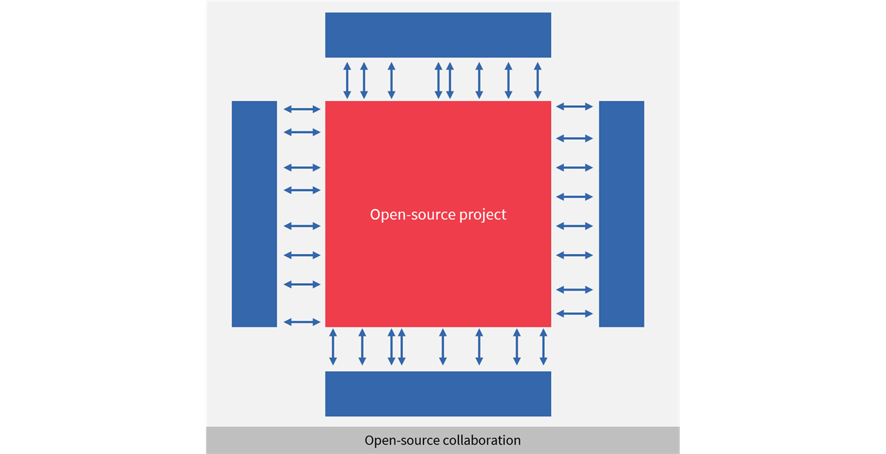

Note that the fact that we are talking about collaboration between companies for SDV applications shows the maturity of SDV. Successful SDV projects used to require vertical integration inside a single OEM, but today SDV systems are being built from components from both commercial vendors and incorporating open-source software.
Indeed, open source is another hot topic in the automotive industry. Several open-source projects aim to build non-differentiating common software bases for the SDV. However, using open-source code in vehicles requires very careful consideration of licenses.

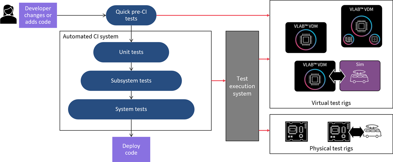

Virtualization for software development and testing is a key supporting technology for SDVs. You cannot depend on hardware rigs for software testing—they are never available in sufficient amounts, or early enough, or flexible enough. Automotive software developers need to be able to run and test code as soon as it is built, and this can only be realized by using virtualization, i.e., by simulating both the computer systems as well as the environment in which it is operating.

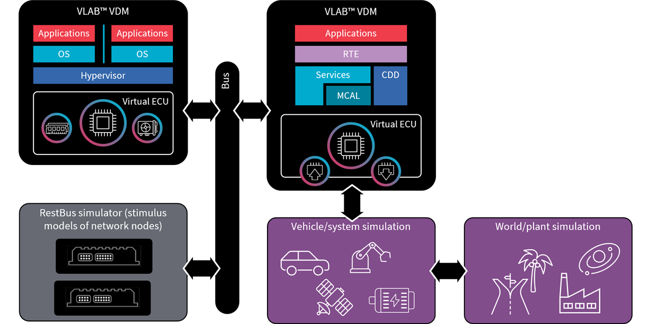

VLAB is commonly used to virtualize the ECU hardware for such setups, allowing the target software to run as-is, interacting with a simulation of the vehicle and the world in which it operates. The virtual test rigs complement the physical test rigs, allowing testing at scale without using physical test rigs except for final testing before release.
In addition, it is not uncommon to virtualize a network of ECUs—for example, zonal controllers alongside their geographical control nodes. Or zonal controllers connected to the vehicle's main "HPC" nodes. Or multiple zones. Or an old-school ECU-rich network. Whatever the architecture of the vehicle happens to be.
Virtualization and collaboration also combine nicely with cloud-based development environments. It is much easier to collaborate on software when new software builds can be tested immediately in the same environment as the build—and using pure software virtualization and simulation definitely makes that much easier than relying on physical hardware test rigs sitting in a lab somewhere.
