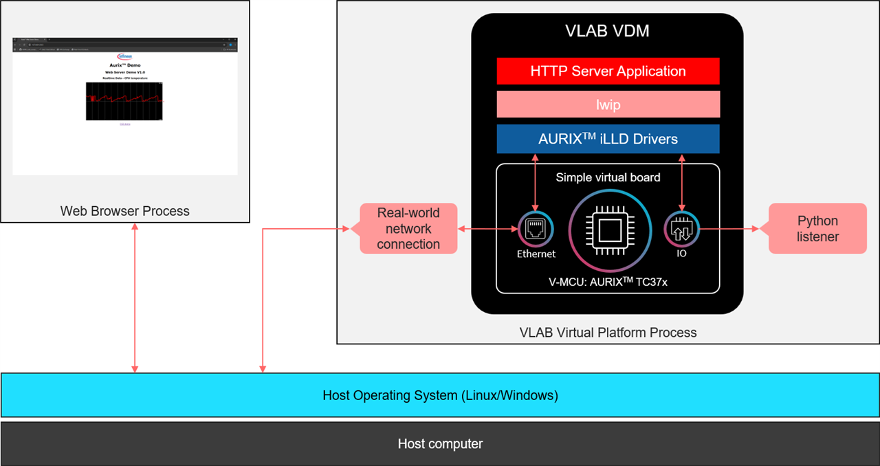

Real software also implies virtually real IO – the software on the virtual platform talks to the outside world through the same hardware drivers and hardware interfaces as the real board. For Ethernet, this results in network packets being sent through a virtual network device to either a virtual network or a connection to the real-world network. In this case, the real-world network is used, allowing a standard web browser to be run on the same host as the virtual platform (or a different host, the virtual platform is on the lab network effectively). The web browser connects to the web server running on the virtual platform, just like it would connect to a real development board.
Building the Software Example “As Is”
We selected Infineon’s iLLD_TC3XX_ADS_GETH_LWIP_HTTP example from the open-source AURIX code examples repository on GitHub. The project was imported into AURIX Development Studio and built as is, using the workflow intended for the hardware target. The resulting ELF image was then loaded into the VLAB AURIX TC37x VDM (Virtual Development Machine) using a VLAB Python script. The script prepares and starts the virtual target, loads the software image, and enables basic interfaces for logging, observing LED activity on a GPIO port, and accessing a UART terminal.

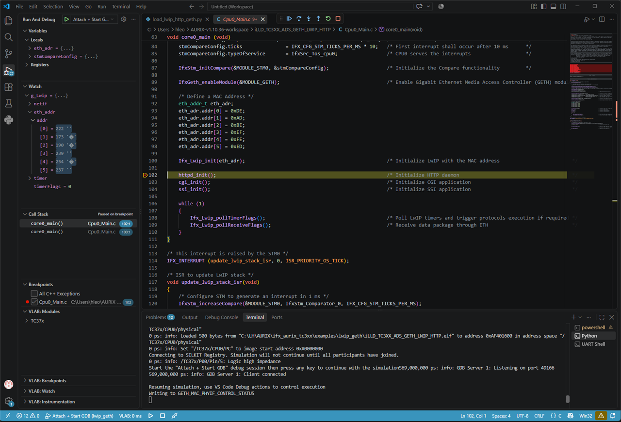

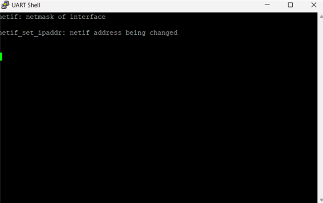

After loading the image onto the VDM, the software started without any problems. However, the HTTP server application did not reach its expected operational state. The UART consoles printed out some initial debug messages, but it did not get to reach the code where it finishes the initialization and prints its IP address.
This is where the virtual development workflow became especially useful. By pausing the application at its entry point and attaching GDB from Visual Studio Code, we were able to debug the target software step by step on the virtual platform, just like you could do with a hardware debugger on real hardware. We could inspect the execution and identify where initialization had stopped progressing. The analysis showed that the software example expected an external Ethernet PHY on the physical hardware, whereas the selected VDM contained the AURIX GETH MAC module but did not include the specific board-level PHY expected by the example.

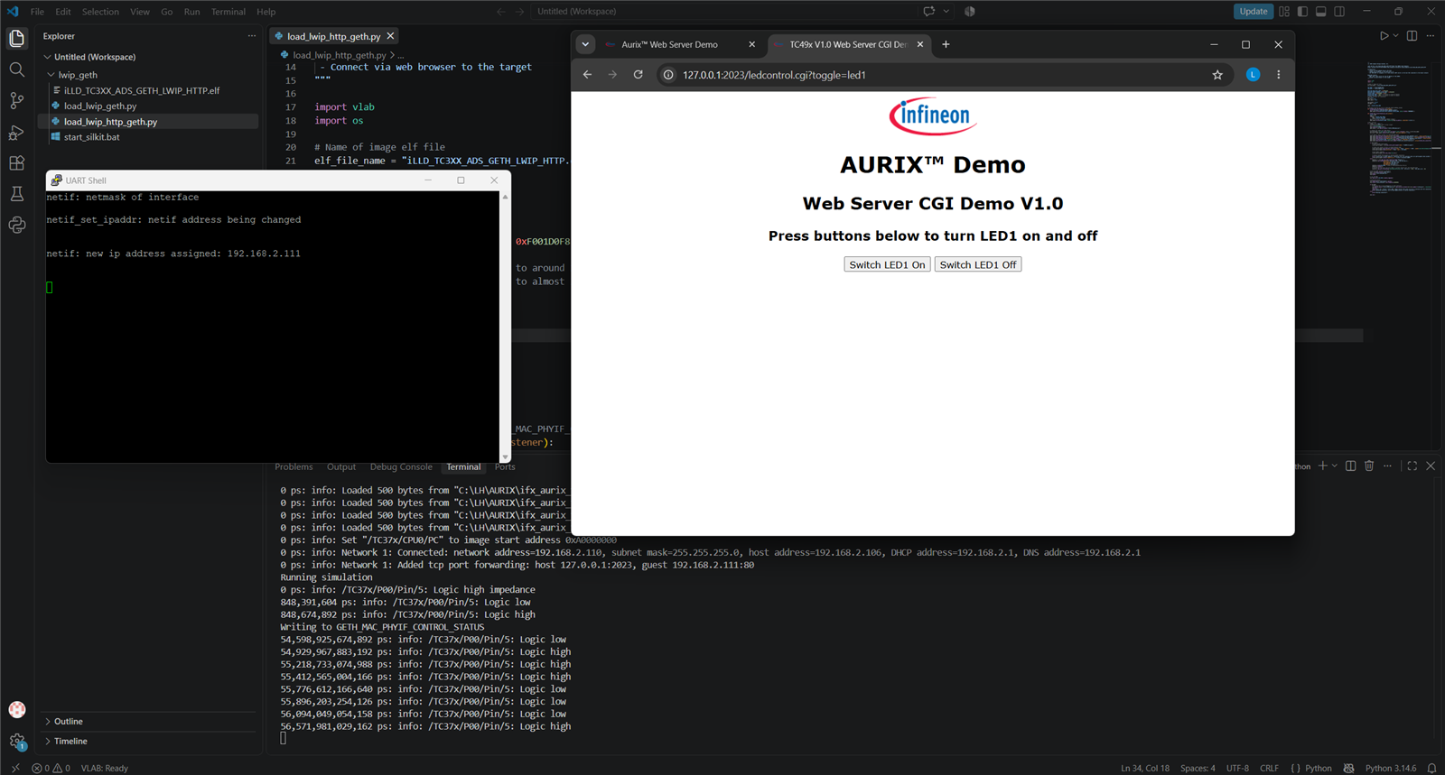

With the target software now fully running, the next step was to connect its virtual Ethernet port to the host environment. This can be also easily done by using the VLAB Python API to create a network bridge between the virtual target and the host machine.
Voilà: Accessing the Virtual HTTP Server in a Standard Web Browser

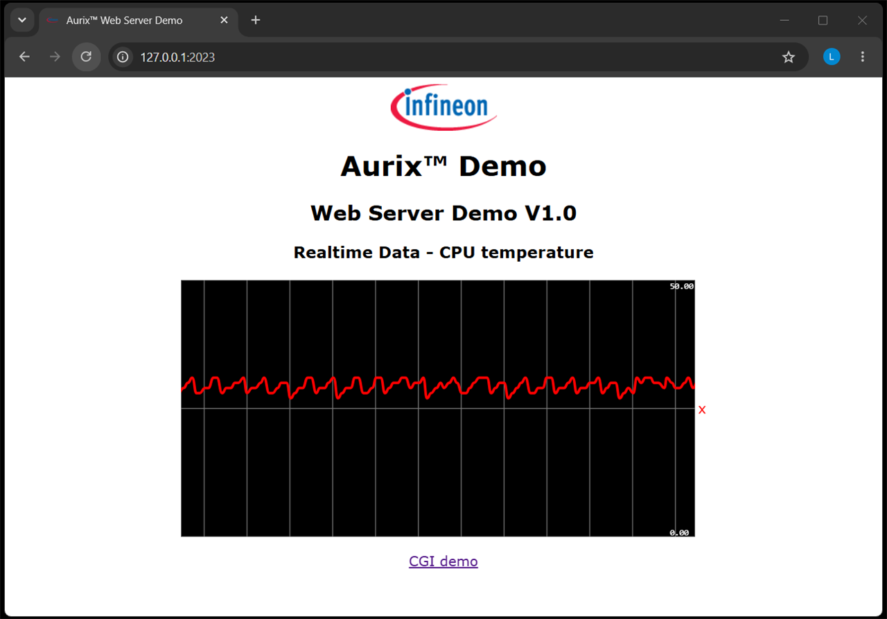

The final result was simple yet satisfying: we opened a web browser on the host machine and connected directly to the HTTP server application running on the virtual target. The page served by the AURIX example code displayed the simulated temperature data and provided controls for exercising the LED port. In the Visual Studio Code output, the resulting LED activity could be observed through logic-port logging.
This result also demonstrates the strong runtime performance of the VLAB virtual target. The web browser regularly requests updated data from the embedded HTTP server—potentially every 100 ms—while the virtual target continues to run the application and respond smoothly. Handling these frequent HTTP requests without noticeable delay shows that the virtual platform provides the performance needed for an interactive web-based application.
