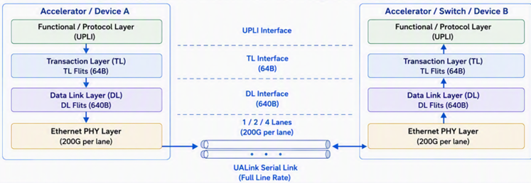

The Journey from Transaction to Wire
Before discussing pacing, it helps to understand where it fits in the UALink stack.
A transaction begins at the functional/protocol layer, is packaged into 64-byte TL flits by the transaction layer, packed into 640-byte DL flits by the data link layer, and ultimately transmitted by the PHY across the serial link.
Figure 1: The UALink protocol stack

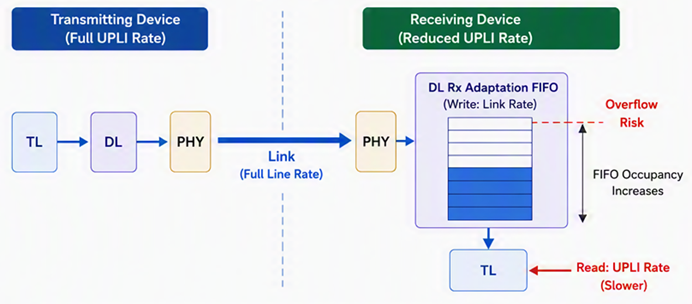

When the Link Is Faster Than the Accelerator
UALink allows accelerators to operate their UPLI clock below the maximum rate to reduce power consumption. The physical link, however, does not automatically slow down.
The receive-side adaptation FIFO is written using a rate derived from the recovered link clock, while data is removed by the transaction layer running on the local UPLI clock. If that UPLI clock is reduced, data can arrive faster than it is consumed. FIFO occupancy grows over time, eventually creating an overflow risk.
Figure 2: Receive-side rate mismatch
This is the problem transmitter pacing was designed to solve.
