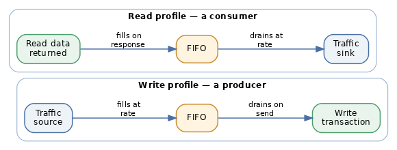

Adaptive Traffic Profiles, defined by Arm as part of the AMBA specification family, take a different approach from a conventional sequence. Rather than describing individual transactions, a profile describes a traffic source or sink that sits behind a first-in, first-out (FIFO) buffer. Three parameters carry most of the meaning: the rate in bytes per clock cycle at which the buffer drains or fills, the buffer depth, and whether the buffer starts empty or full.
Traffic then generates itself from that description. A read profile models a consumer: the buffer drains at the specified rate, and a transaction is issued only when enough space exists to hold the data that will be returned. A write profile models a producer: the buffer fills at the specified rate, and a transaction is issued only once enough data has accumulated to send.
Write and Read ProfileThe rate always applies to the traffic side of the buffer; the bus drives the other side. That asymmetry is the whole model.
The word adaptive is the important one. Because the buffer level responds to the latency the design under test actually returns, a profile throttles itself when the fabric gets congested and catches up when the fabric clears. Traffic shapes itself around the design rather than being replayed blindly at it.

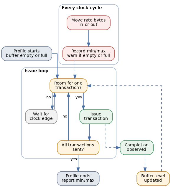

AMBA ATP Flow
Two loops run concurrently. The buffer fills and drains every cycle, while the issue loop consults the level before sending anything, which is where self-throttling comes from.

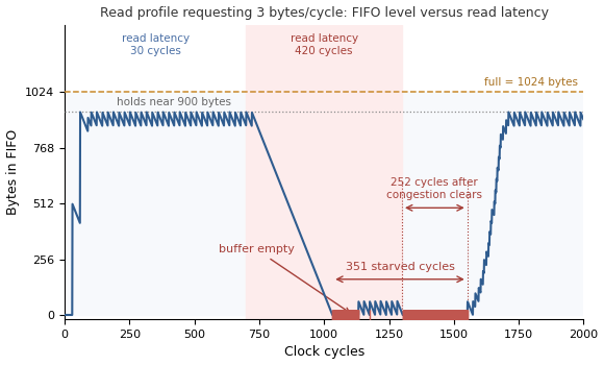

Seeing the Result
FIFO level vs read latency
A read profile requesting three bytes per cycle. The buffer holds near 900 bytes while read latency is 30 cycles, drains once latency rises to 420, and then starves for 351 cycles, continuing for 252 cycles after the congestion itself has cleared. A buffer that reaches empty once the profile is running is the failure signature.
The reported buffer levels answer the original question. A read profile whose minimum level stays well clear of zero was served comfortably throughout. One that reaches empty indicates a design that could not meet its own requirement, and the margin between that minimum and the buffer depth quantifies the headroom left for the next derivative. A bandwidth number stops being a spreadsheet entry and becomes a simulation result with a pass or fail attached.
