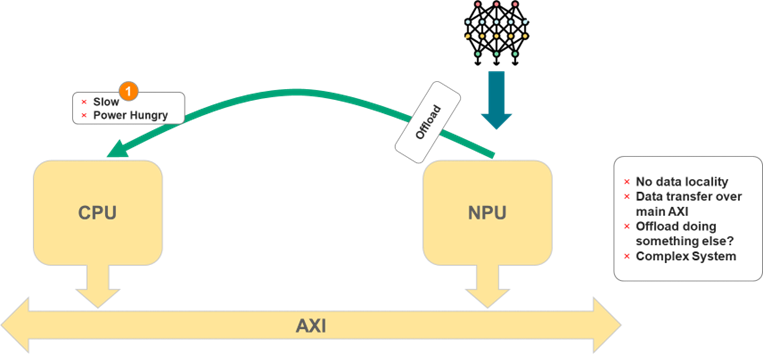

If we focus specifically on the Gen 1 NPUs, these are the embodiments of the AI-at-the-edge philosophy and are highly optimized for one thing: massive matrix multiplication, which forms the core of a CNN-based model. When these NPUs encounter a layer they don't support, they have no choice but to stop, hand the data over to the main host CPU, wait for it to finish, and then retrieve the data. This creates three major architectural issues in an AI subsystem:
  • CPU Bottleneck: A general-purpose CPU is architecturally inefficient at performing the parallel data processing required for these AI layers. This offloading process becomes the slowest part of the entire AI inference pipeline.
  • Data Traffic Jam: Constantly moving large tensors between the NPU's memory, the CPU's caches, and system DRAM consumes significant power and time, adding latency and negating the NPU's efficiency benefits.
  • Increased System Complexity: Software developers must manage this complex, fragmented workflow. The AI model is no longer running on a single accelerator but is partitioned across multiple processors, making performance unpredictable and debugging difficult.
These issues have become even more pronounced with the rise of complex transformer models. These models introduce operations like more complex Gaussian error linear unit (GELU), layer normalization, Softmax, complex element-wise operations, etc., that a type A NPU is forced to offload, creating new system bottlenecks.

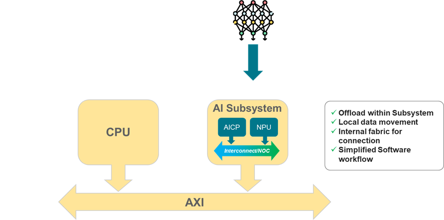

A Hybrid Architecture: NPU + AI Co-Processor (AICP)
These limitations warrant a new approach to designing the AI subsystem: a hybrid architecture. Pairing the NPU with a companion such as the Cadence Tensilica NeuroEdge 130 AI Co-Processor, which is designed specifically to handle these offload tasks, can create a more powerful and efficient AI subsystem, simplify the design, and accelerate time to market.
The end-to-end inference flow for this kind of hybrid AI subsystem is a multi-step process that strategically leverages the strengths of both the NPU and NeuroEdge 130 AICP. The successful execution of ViT, a vision transformer, looks as detailed below and this could apply to any model, including LLMs and VLMs:
Step 1: Offloaded Pre-Processing: The NeuroEdge 130 AICP performs the initial, data-intensive, and non-MAC-heavy pre-processing tasks, including dividing the image into patches, converting them into tokens, and applying positional encodings.
Step 2: NPU-Centric Compute: Once the data is prepared, the NeuroEdge 130 AICP, acting as the control processor, transfers the data to the NPU, where the MAC unit computes the math-intensive tasks. This streamlined data flow ensures the NPU's expensive parallel units are kept at near-constant, high-level utilization.
Step 3: Offloaded Post-Processing: After the core computational layers are completed on the NPU, the aggregated output is returned to the NeuroEdge 130 AICP. The AICP then handles the final classification/post-processing tasks, including the pooling and the final SoftMax activation, which is specifically optimized to perform.
Step 4: Output Generation: The final classification probabilities are produced by the NeuroEdge 130 AICP, completing the inference cycle.

The Benefits of a Hybrid Architecture
  • Enabling Advanced Features: A more capable AI subsystem allows for the deployment of cutting-edge features—like on-device generative AI, advanced sensor fusion, and multi-modal models—that would be impossible on a gen 1 NPU, creating significant product differentiation.
  • Lower Power and Smaller Area: By using a purpose-built co-processor instead of an inefficient general-purpose CPU, designs can achieve a significant reduction in dynamic power and optimal silicon area, lowering manufacturing costs and extending battery life.
  • Faster Time to Market: The combination of a mature, extensible hardware architecture and a unified software development kit (SDK) reduces development complexity and risk, allowing teams to bring innovative AI-powered products to market faster.
