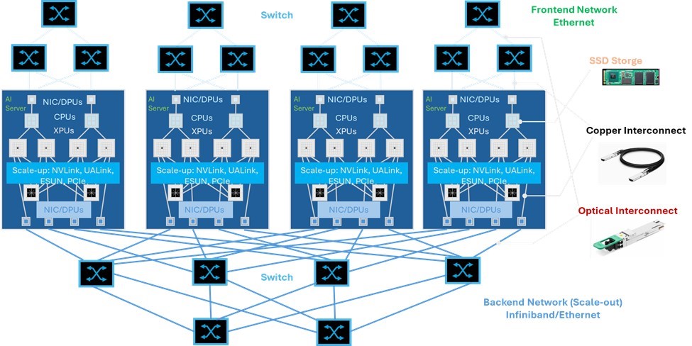

AI Data Center Interconnect Architecture
AI data centers use a mix of copper and optical connectivity. Copper is typically used within a tray and inside a single rack, while optics serve the inter-rack domain where distances and bandwidth demands escalate. These optical interconnects make it possible to link thousands of GPUs into a single cluster and then to aggregate multiple clusters into systems containing tens of thousands of GPUs.

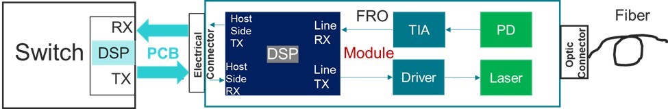

Block Diagram of FRO

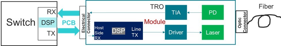

Block Diagram of TRO (LRO)

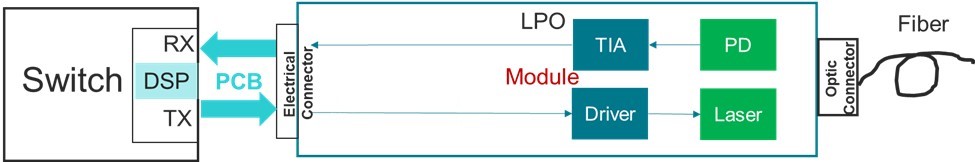

Block Diagram of LPO
FRO modules offer the highest levels of signal integrity and interoperability by employing DSP-based retiming on both the transmit and receive paths. This superior signal performance comes at the cost of higher power consumption, increased latency, and greater expense.
LPO represents the opposite end of the spectrum by removing the DSP entirely from the module and relying on the host SerDes to manage retiming and signal conditioning. This approach achieves much lower power, latency, and cost but introduces challenges in signal robustness and interoperability.
TRO/LRO strikes a middle ground by applying DSP retiming only on the transmit side while depending on the host for receive-side processing. This configuration balances performance, cost, and power in a way that aligns well with many AI infrastructure designs

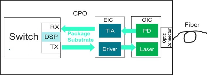

Block Diagram of CPO
CPO represents a transformative shift in high-speed optical interconnects. It integrates the optical engine directly alongside the host ASIC within the same package, eliminating the need for traditional pluggable modules. By dramatically shortening electrical channels, CPO reduces insertion loss and lowers overall power consumption while enabling the extreme bandwidth density required for the next generations of connectivity: 800G, 1.6T, and especially 3.2T. CPO optical engines are built on silicon photonics, where modulators, photodetectors, and waveguides form a tightly integrated optical integrated circuit. Pluggable external lasers enhance reliability and serviceability in these dense, high-power environments.
However, the advantages of CPO are accompanied by significant challenges. Power density around the integrated optical engine is extremely high, demanding advanced thermal solutions. CPO, like LPO, depends on DSP and retiming within the host ASIC, which shifts complexity into the system architecture. Integrating CPO requires deep co-optimization between system and optics teams, alignment across a diverse supplier ecosystem, and careful navigation of standardization and vendor-related business considerations. Even so, CPO remains one of the most promising technologies for addressing the physical limits of copper and pluggable optics in the 3.2T era.
