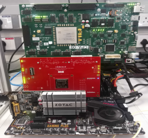

Many of these conditions extend beyond the baseline scope of PCIe compliance validation. To address that gap, Cadence developed additional internal stress-testing methods that evaluate PCIe IP under broader electrical, functional, and system-level conditions. These methods build on standard compliance and qualification practices, extending them into more realistic operating scenarios to improve confidence in field reliability.
Figure 1. Cadence generic multi-lane PCIe validation test setup
