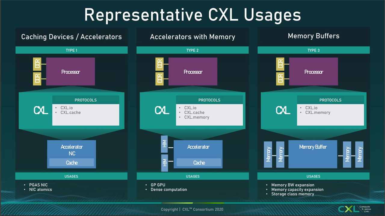

Compute Express Link® (CXL®) was created to address these problems through CXL.mem, which offers memory expansion, memory sharing, and CXL.cache to ensure data coherency within the fabric; all while maintaining the basic PCIe structures for communication via CXL.io.

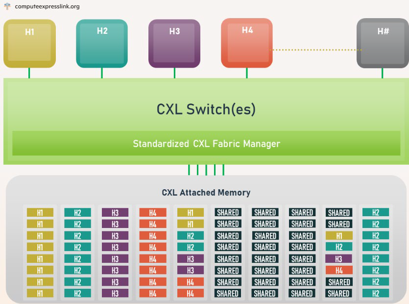

Beyond its memory expansion capability, CXL facilitates memory pooling and resource sharing across multiple devices to enhance AI processing. With CXL, multiple processors, GPUs, and AI accelerators can access the same shared memory pool, facilitating efficient resource utilization. AI systems are then able to dynamically allocate memory as workloads grow, eliminating the constraints of traditional, fixed-memory architecture. This flexibility allows for the intensive memory requirements of large AI models, such as GPT-4. In addition, CXL's disaggregated architecture optimizes resource utilization and overall system efficiency, making it a perfect fit for AI workloads.
Source: From CXL Consortium
