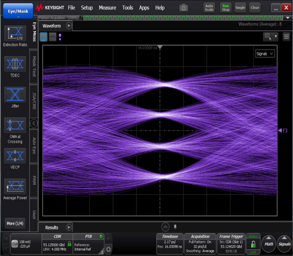

High‑speed 112G PAM4 SerDes IP was exercised on Intel 18A as a foundation for bandwidth‑intensive AI, networking, and accelerator applications.
12G SerDes PAM4 eye diagram
Figure 1: 112G SerDes PAM4 eye diagram

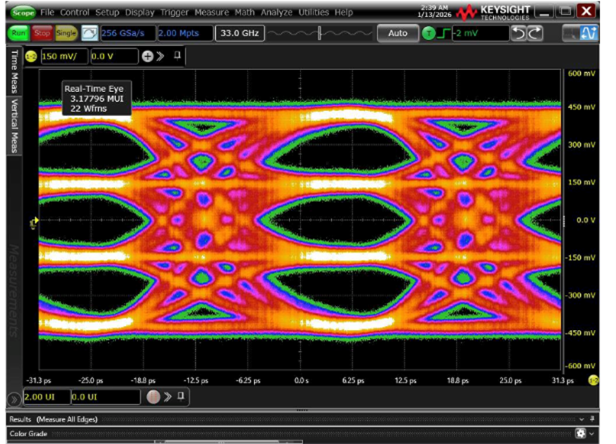

The test chips also support PCI Express® (PCIe®) 6.0 (64 GT/s PAM4) and PCIe 5.0 (32 GT/s NRZ) PHY IP operation, reflecting the continued evolution of high‑bandwidth I/O and coherent system architectures.
Figure 2: PCIe 6.0 Eye Plot

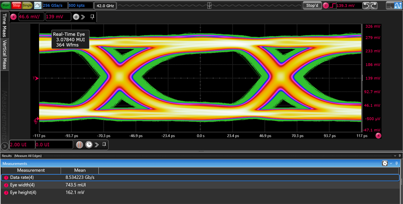

For the memory subsystem, LPDDR5 PHY IP was validated at high data rates on Intel 18A, supporting the power‑efficient, high‑performance memory interfaces required for advanced SoCs.
Figure 3: LPDDR5 8533 Mbps Tx/Rx Eye Diagram

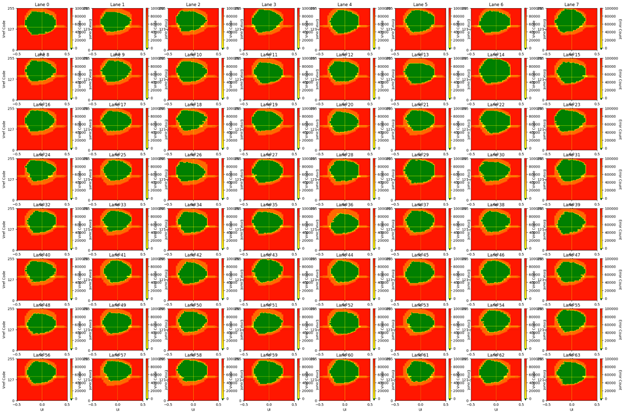

Also demonstrated in the test chips was UCIe™ IP, including multi‑lane configurations and packaged implementations that align with emerging chiplet‑based system designs.
Figure 4: UCIe-AP 16G Eye Plot – 64 Lanes
