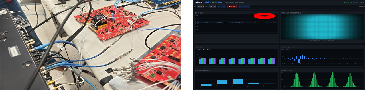

In the demonstration, a data link was established using a Keysight arbitrary waveform generator (AWG) transmitting to a Cadence PHY receiver. The system demonstrated good bit error rate (BER) performance. The SerDes used in the demo builds on Cadence's advanced DSP-based transceiver architecture, which has been leveraged across multiple generations of PAM4-based standards, including PCIe 64 GT/s and 128 GT/s, as well as Ethernet 56G, 112G, and 224G.
