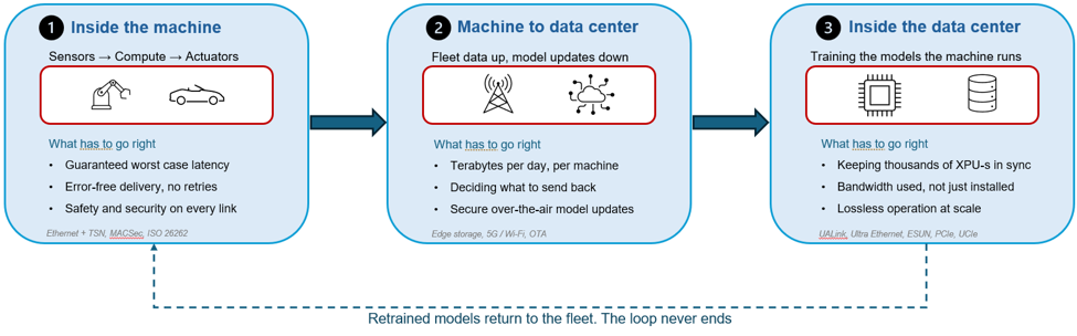

Figure 1: Physical AI runs on three networks
The rest of this post examines each network.

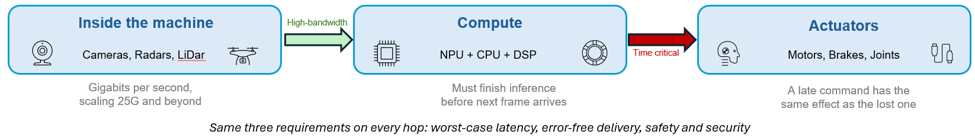

Inside a physical AI machine, data crosses several different interfaces between the moment a sensor captures something and the moment an actuator responds. Each hop uses the interface built for it, and each hop has a deadline.
Figure 2: Inside the machine, every hop is a different interface with a deadline
Cameras, radar, and lidar connect to compute over sensor interfaces such as MIPI CSI-2 and automotive SerDes, or over automotive Ethernet where sensors are aggregated by a zone controller. Inside the compute module, the NPU, CPU, and memory talk over an on-chip interconnect and memory interfaces such as LPDDR. Traditionally, the CPU, NPU, and other processing elements have been integrated into a monolithic SoC, but we are seeing more designs move toward chiplet-based architectures connected over UCIe.
Storage and additional accelerators attach over PCI Express® (PCIe®) and Compute Express Link (CXL). Commands go out to motors, brakes, and joints over deterministic networks: Time-Sensitive Networking (TSN) Ethernet in vehicles, EtherCAT in robots, and controller area network (CAN) for simpler nodes. Humanoid platforms coordinate 30 to 40 servo axes this way with sub-millisecond synchronization.
While the interfaces differ, the requirements do not, and three of them govern every hop:
Worst-case latency
A control loop does not care about average delay. It cares whether the slowest transfer still arrives on time. On the sensor side, that means a frame has to be in memory before the model needs it. On the actuator side, it means a command has to reach the motor before the next control cycle. Deterministic networking exists for this: TSN on Ethernet aligns every node to a common clock and reserves slots for control traffic, so a brake command is never queued behind a camera frame. The same idea, a bounded and predictable delay rather than a fast average, has to hold on PCIe, on the memory interface, and on the die-to-die link once chiplets arrive, or the deadline is missed somewhere else in the chain.
Reliable delivery
In a data center, a dropped packet can often be retransmitted without affecting physical safety. Inside a machine, a lost brake command or joint update may not be recoverable within the control deadline. A retry that completes inside the link, in nanoseconds, is acceptable. A retry that reaches software is not, which is why error correction, link-level replay, redundancy, and fault detection are built into the interface itself rather than handled above it.
Safety and security
The interfaces have to support functional safety through fault detection and diagnostic coverage, enabling the system to meet ISO 26262 and applicable Automotive Safety Integrity Level (ASIL) requirements in vehicles, or IEC 61508 and applicable Safety Integrity Level (SIL) requirements in industrial and robotic systems. And every link has to be secured at line rate. A spoofed sensor frame in a data center is a data breach. In a vehicle, it is a collision.
The interfaces inside the machine are part of the control system, not data pipes.

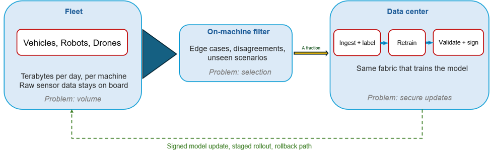

Figure 3: Between the machine and the data center, a little data goes up, and one model comes down
Volume
A deployed autonomous vehicle is commonly estimated to generate several terabytes of sensor data per day, with some operators citing 4 – 5 TB per hour of raw data. A fleet of a few thousand machines produces more raw data in a day than it can practically upload, and far more than a data center can usefully label. The raw stream has to stay on the machine. The fraction that leaves is compressed and batched, sent opportunistically when the machine is on Wi-Fi at a depot or charger, or pulled over a wired service port such as USB4, rather than in real time over cellular. The in-machine network has a role here that is easy to miss: the same in-machine backbone that feeds the compute module also has to feed on-board storage and the telematics unit without stealing bandwidth from the control loop.
Selection
Choosing that fraction of data that goes back is a design decision that shapes the next model. The useful data is the data the current model handled badly: scenarios where its confidence was low, it disagreed with a human driver or operator, a safety intervention fired, or a newer model running in shadow mode would have chosen differently. That triage runs on the machine, on the same compute that runs inference, which means part of the edge compute budget is spent deciding what the data center should learn from. Right-sized inference includes providing enough compute to run the model and select useful data without exceeding the machine's power, thermal, and size limits. The better the selection, the smaller the upload and the faster the model improves.
Secure updates
The retrained model comes back over the air, and this is where the link becomes safety-critical after all. An update changes how the machine behaves. Every deployed machine has to verify that the update was signed by the right authority, has not been altered in transit, and is the version intended for that hardware. Rollouts are staged, beginning with a subset of deployed machines and retaining a path to rollback if the new model behaves unexpectedly. Secure model delivery is one part of trusted execution, which protects data, models, and devices across the full lifecycle. Vehicle regulation now requires this: UN Regulation No. 156 mandates a software update management system for type approval, and ISO 24089 defines the engineering process behind it. Robotics fleets do not yet face the same rules, but the operators running them face the same risk.
This exchange supports continuous model improvement after deployment. Although the machine operates independently in real time, the cadence of data collection, retraining, validation, and secure deployment determines how quickly its models can improve.

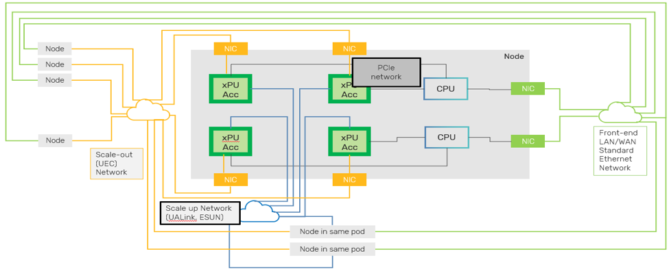

Figure 4: Inside the data center, scale-up and scale-out as one execution path
The infrastructure that trains a robot policy is also the infrastructure that trains a language model. Thousands of accelerators exchange parameters, activations, and gradients across a scale-up fabric inside the pod and a scale-out fabric across pods.
Training and testing these models place the same fundamental demands on AI infrastructure as other large-scale AI workloads: synchronization, high utilization, and lossless operation at scale.
Synchronization
Collective operations have to be completed before the workload advances. If one accelerator is waiting on a slow link, every accelerator in the group waits with it.
Utilization
Installed bandwidth is not delivered bandwidth. Retransmissions, congestion, and header overhead all reduce how much of the fabric actually carries model state. Link-level retry, credit-based flow control, and compact headers exist to close that gap.
Lossless operation at scale
A fabric of thousands of endpoints must remain lossless under load, across multiple paths, without head-of-line blocking. UALink for scale-up, Ultra Ethernet for scale-out, and Ethernet for Scale-Up Networking (ESUN) are standards being defined to do exactly that.
