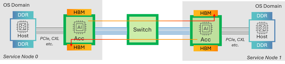

Interconnect Becomes an Extension of the Memory System
Model partitioning forces data to move across accelerators. Activations generated on one device become inputs for another. Gradients must be aggregated across devices, and parameter updates must be distributed across the system. At AI factory scale, these exchanges extend well beyond the local memory attached to a single accelerator and depend directly on interconnect performance.
From a system perspective, interconnect increasingly becomes an extension of the memory system. It moves data between distributed regions of model state and directly affects how quickly those regions can be accessed, updated, and synchronized.
The dominant communication patterns are collective operations. Reductions, broadcasts, and exchanges must be completed across groups of accelerators before the workload can advance. If interconnect performance varies, or if communication cannot sustain the required pattern, execution time increases even when compute resources are available. The issue is not that the accelerator lacks capability. The issue is that the system cannot deliver the data and synchronization needed to keep execution moving.
This is why interconnect should not be treated as a separate infrastructure layer. In an AI factory, it is part of the execution path.

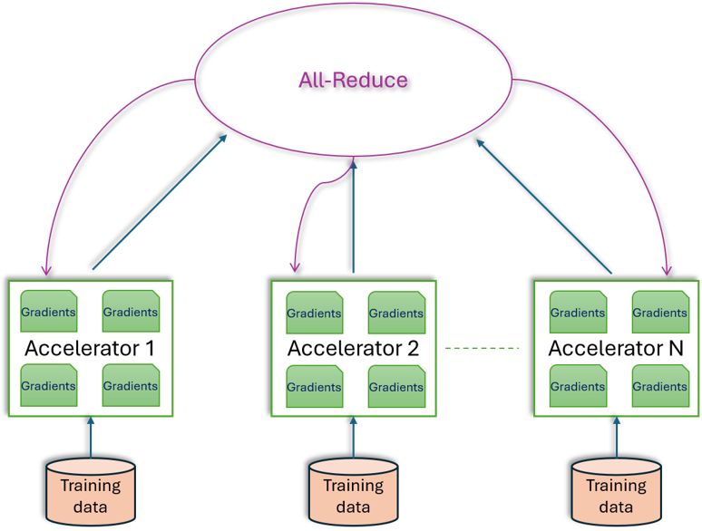

Synchronization and System Efficiency
Each training step includes local computation, data exchange across devices, completion of collective operations, and synchronization before the next step begins. All participating accelerators must complete these stages together.
That creates a system-level straggler problem. If one device is delayed by data arrival, communication latency, or contention, the rest of the group cannot simply continue. They wait at the synchronization point until the operation completes.
As accelerator counts increase, sensitivity to synchronization overhead increases as well.

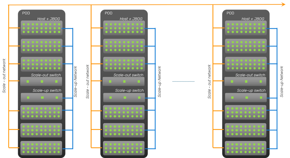

Scale-Up and Scale-Out Must Work as One System
Scale-up communication connects accelerators within a tightly coupled domain. It supports frequent data exchange and low-variation synchronization inside a local group of devices. Many collective operations depend on this communication, completing quickly and consistently.
Scale-out communication extends workloads across nodes and clusters, allowing model partitions and execution to span the broader AI factory.
These domains serve different purposes, but they are not independent. Inefficiency in either introduces delay into the same execution flow. A workload distributed across multiple accelerators still relies on communication and synchronization to progress, regardless of where the communication occurs.
Separating scale-up from scale-out does not isolate the performance challenge. It only changes where communication overhead appears in the system.
