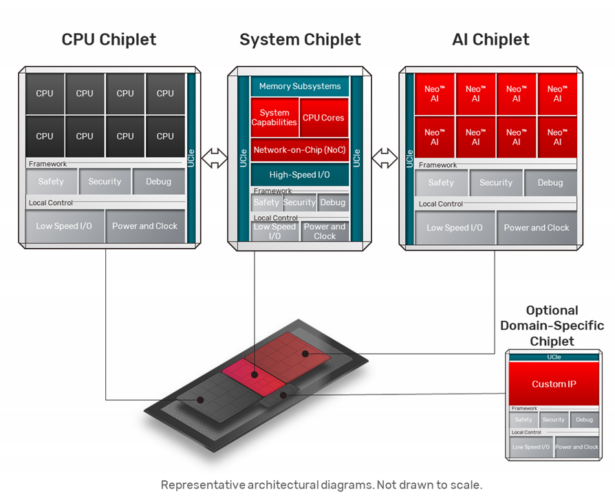

For applications such as automotive ADAS, robotics, drones, and aerospace and defense, the physical AI chiplet platform answers these challenges with a modular design. By disaggregating a large SoC into separate, specialized chiplets for (1) compute, (2) system management with memory and I/O, (3) AI engines, and (4) optional domain-specific functions, the platform enables cost reduction, customization, and flexible configurations. At the center of this architecture is the Cadence System Chiplet, which orchestrates communication, manages resources, and serves as the backbone of the entire platform.
Figure 1. Cadence's Physical AI Chiplet Platform

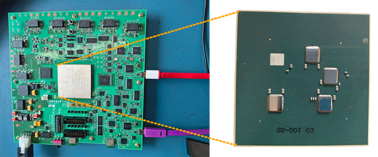

Engineering a chiplet-based platform from concept to working silicon is a meticulous, multi-stage process. The successful bring-up of the System Chiplet, a critical component of the physical AI chiplet platform, showcases Cadence's deep technical expertise and demonstrates the maturity of this modular approach. The platform integrates multiple instances of the same System Chiplet die, enabling the system to mimic multiple application use cases.
Figure 2. Package image diagram and actual photo of package of dies

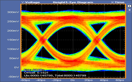

After the individual die initialization, it was time to move on to the multi-die chiplet-to-chiplet configurations. This pivotal step in the process involved bringing up and validating the UCIe high-speed die-to-die interface, which is essential for reliable chiplet communication. One chiplet was configured as the multi-die initiator, and after completing its own secure boot, it went on to manage the initialization of the secondary chiplet. This is a baseline function of the Cadence Chiplet Framework, which I will share more about later. The engineering team carefully executed power sequencing, link training, and initial handshake routines across chiplets. Through exhaustive testing and measurements, we verified signal integrity, error rates, and lane reliability. Importantly, and with a significant margin, we successfully validated the 32Gb/s UCIe performance across the 25mm link (the maximum link length per UCIe specification) and shorter 7mm links implemented in the package. This successful milestone not only proved interoperability between chiplets at the raw electrical and protocol layers but also validated the robustness of the Cadence UCIe implementation.
Figure 3. UCIe-SP32G RX Eye Opening (25mm Link)

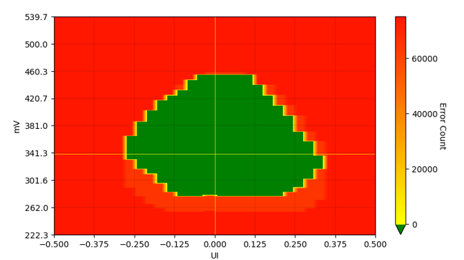

Maximizing AI performance requires high-speed memory access, deeply integrated into the system's core architecture. The bring-up and validation of the LPDDR5X 9600 memory interface represented the next major Cadence System Chiplet bring-up accomplishment. It includes the latest Cadence LPDDR5X IP solution, with the interface brought online and successfully trained for robust operation at 9600 Mb/s. With the memory subsystem operational, extensive stress tests—including demanding read/write patterns and high-bandwidth streaming—confirmed error-free, sustained high performance even with concurrent access across chiplets. Each chiplet in the two-chiplet system enables a unique configuration, so multiple realistic use cases could be validated. Test cases included disabling the memory subsystem in one chiplet and having the other chiplet read and write to memory across the chiplets' UCIe connections. Another test case configured the LPDDR5X interfaces on each chiplet, building a shared memory structure. The Cadence System Chiplet's central management ensured optimal memory utilization, empowering the physical AI chiplet platform to deliver advanced AI throughput and efficiency.
Figure 4. LPDDR5X Write Eye, excellent electrical margin (overclocked at 14.6Gbps)

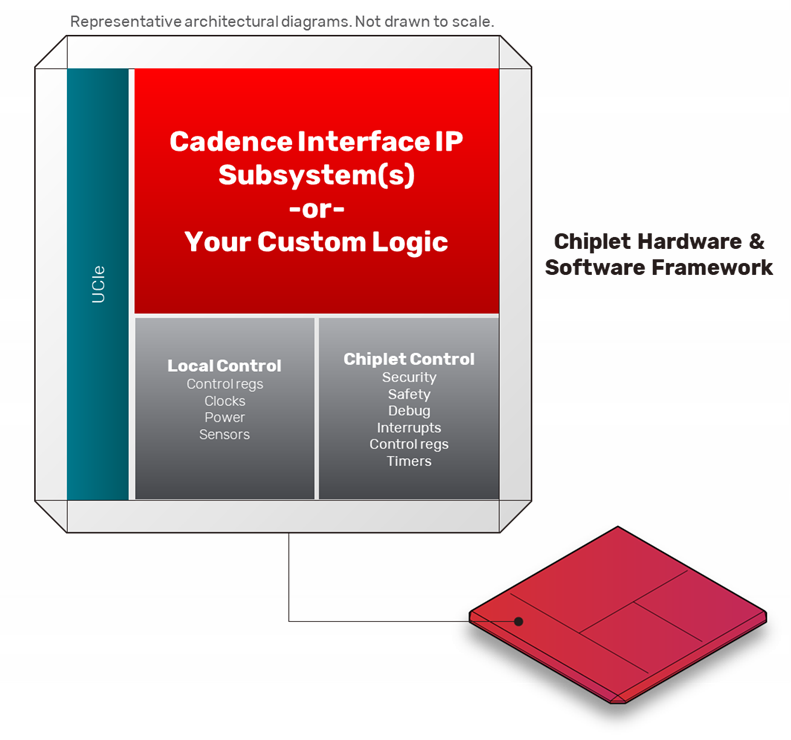

Another fundamental milestone centered on testing the Cadence Chiplet Framework itself, which served as a key criterion for the platform's success. This framework underpins the platform's modular architecture, defining standards for integration, discovery, management, secure boot, functional safety, and coordinated function among heterogeneous chiplets. The validation process included orchestrating complex operations across combinations of chiplets, verifying that each functional block could be independently managed, dynamically allocated, and automatically detected by the platform. Inter-chiplet workflows, error reporting, and platform-level configuration were demonstrated to operate seamlessly, confirming both the extensibility and robustness of the modular design. Proven Chiplet Framework integration ensures the platform supports rapid innovation, simple scalability, and reliable interoperability as new chiplets and workloads are introduced.
Figure 5. Cadence Chiplet Framework capabilities
