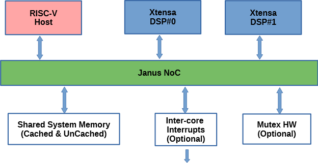

Figure 1 depicts a sample architecture with one RISC-V core and two Xtensa DSPs. A configurable Janus NoC connects all the system components.
Figure 1 System Block Diagram
The RISC-V specification specifies various ISA options and features, and RISC-V processors can range from simple microcontrollers to cache-coherent Symmetric Multiprocessing (SMP) clusters.
The designer can select either an Xtensa CPU or an Xtensa-based DSP with an ISA optimized for Baseband/Radar, Vision/AI, or Audio applications. Xtensa DSPs are VLIW and SIMD machines. Depending on the application workload, a system architect can pick a SIMD width that maximizes hardware utilization while meeting the area budget.
To optimize the system from a PPA perspective, Xtensa offers power-saving features such as Wait-for-Interrupt (WAITI) and Power Shut Off (PSO). Custom instructions and hardware accelerators can be added to Xtensa DSPs, enabling the system architect to significantly improve performance with minimal impact on area and power.  Leveraging these power-saving features and acceleration helps system architects meet and exceed their system design goals.
The designer can create an interconnect based on the Janus NoC, which supports multiple system interface types (AXI4, ACE-Lite, and AHB), multiple clock domains, and multiple physical partitions. A configurable NoC enables designers to optimize critical paths for bandwidth and latency in their heterogeneous multicore environment. NoCs are especially valuable when facing wire congestion and timing closure issues, which are common in large SoCs.

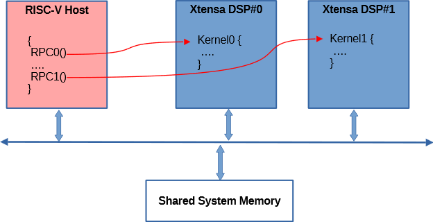

Figure 3 depicts an offload engine in which the RISC-V application dispatches work to each DSP via a Remote Procedure Call (RPC). An image processing application might exploit data-level parallelism, while a baseband signal processing application might decide to implement task pipelining. The Xtensa SDK includes an RPC library, XRPC, which consists of two parts: the DSP and the host. The XRPC DSP build runs on Xtensa cores, while the XRPC Host build runs on RISC-V cores with minimal porting effort. The host and DSP communicate through shared memory to exchange input data and results. The XRPC library supports both interrupt and flag-based synchronization between the host and the DSP.
Figure 3 Offload Engine
Dynamic Kernel Loading
Xtensa SDK also includes a library loader. RPC can be combined with the library loader to dynamically load kernels onto DSPs. Kernel0 and Kernel1 in Figure 3 can be loaded by the host application before execution. The DSP kernel is pre-compiled as a position-independent library.

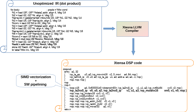

Application developers can specify DSP code in their preferred programming language. Xtensa LLVM-based tools consume unoptimized intermediate representation (IR) to generate optimized machine code, as shown in Figure 4.
Figure 4 IR Translation

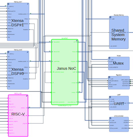

For cycle-accurate profiling, customers can map their heterogeneous design onto an FPGA. Here’s a video tutorial on Xtensa DSP FPGA Emulation. Figure 5 shows a design mapped onto an Xilinx KC705 board.
Figure 5 FPGA Emulation

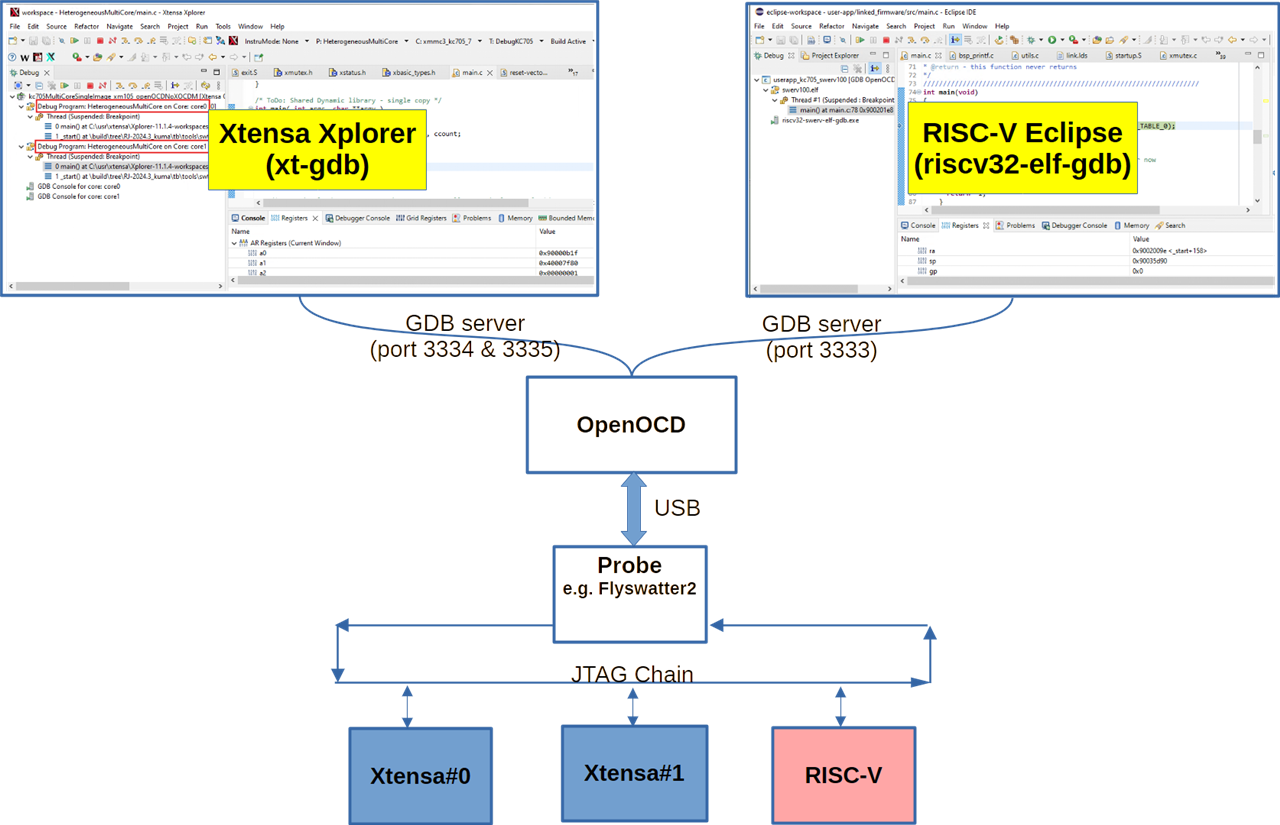

Figure 6 illustrates a debug scheme. OpenOCD connects to the target cores via the JTAG probe. RISC-V and Xtensa GDB instances connect to their respective target cores via OpenOCD GDB server ports. Both the RISC-V and Xtensa IDEs provide standard source-level debugging. Each core can be reset independently. Synchronous debugging is supported. Note that two Xtensa DSP debug contexts are annotated in red in Figure 6.
Figure 6 Debug Setup
