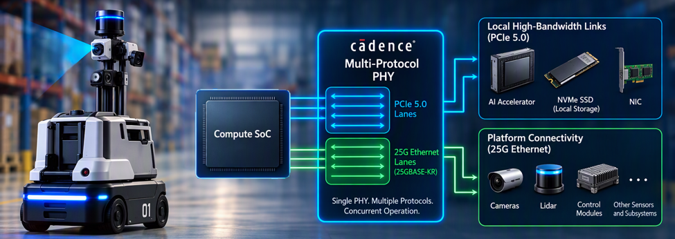

Consider an autonomous mobile robot moving through a warehouse. Cameras and lidar continuously capture its surroundings, and an AI accelerator processes those inputs for object detection, localization, and path planning. Control modules send commands to motors and actuators, while selected sensor and inference data are written to local storage. All of this happens at once, so both connectivity domains must stay active while the robot operates.

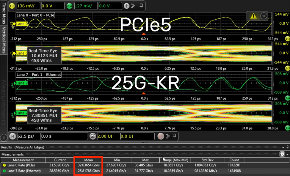

PCIe 5.0 and Ethernet map naturally onto these two domains. PCIe 5.0 provides the local connection to accelerators and storage. Ethernet carries traffic across the larger platform, and this article focuses on 25G Ethernet. The demonstration shown above uses 25GBASE-KR, the 25G Ethernet interface defined for electrical backplane-style channels.
Instead of implementing a dedicated PHY for each protocol, designers can use a multi-protocol PHY: a single high-speed PHY whose lanes can be configured for different interface standards. Multi-protocol PHYs can support additional standards as well, but the PCIe 5.0 and 25G Ethernet pairing offers a clear example of how the approach works. Separate lanes are assigned to each protocol, allowing both to operate concurrently without duplicating the PHY.
PCIe 5.0 and 25G Ethernet operation within a multi-protocol PHY for physical AI connectivity
Assigning Traffic and Lanes
PCIe 5.0 is suited to traffic that stays close to the compute SoC. In the warehouse robot, it can connect the SoC to an NPU, GPU, NIC, or NVMe SSD, carrying sensor data, model data, intermediate results, and inference output between high-performance components.
25G Ethernet serves the rest of the platform. It can link camera and sensor modules, distributed compute, and control subsystems located elsewhere in the robot, so physically separated modules can exchange data without routing everything through the local PCIe fabric.
The two paths are separate but closely linked. Sensor data arrives over 25G Ethernet and moves to the AI accelerator over PCIe 5.0. The resulting inference output then drives a control decision while selected information is written to storage. Because these activities overlap during normal operation, both links must carry traffic at the same time.
A multi-protocol PHY meets this requirement by dividing its lanes between the two protocols. One lane group operates as PCIe 5.0, while another operates as 25G Ethernet. Each lane is configured for a single protocol, so no individual lane carries PCIe and Ethernet traffic simultaneously. Concurrency comes from running both lane groups in parallel within the same PHY.
Simultaneous PCIe 5.0 and 25G Ethernet (25GBASE-KR) operation over separate lanes of a multi-protocol PHY
