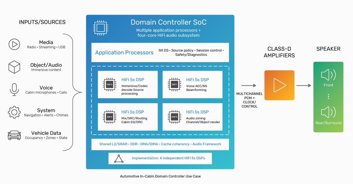

The result of that joint effort is a design in which Cadence Tensilica HiFi 5s DSPs handle the real-time audio and voice workloads on-chip, eliminating the need for a separate external audio device while supporting a large multi-microphone and multi-speaker array for multi-zone, immersive in-cabin sound.
X10 incorporates four Cadence Tensilica HiFi 5s DSPs, which handle audio and voice processing while CPU, GPU, and NPU resources stay dedicated to application, graphics, and large-model AI workloads. The HiFi 5s DSP also enables AI-based speech and audio AI, allowing the chip to deliver the real time execution of those functions.
