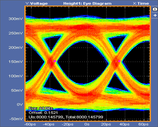

Coinciding with the release of the JEDEC specification, Cadence announced the availability of its LPDDR6/LPDDR5X 14.4Gbps dual-mode PHY and memory controller. Fabricated using advanced process nodes and taped out earlier this year, this solution delivers peak performance at 14.4Gbps in LPDDR6 mode while operating at core voltage. To maximize design flexibility, the PHY also supports LPDDR5X at speeds of up to 10.7Gbps. Both the PHY and controller are now available, with numerous customers actively engaged in chiplet and monolithic designs.
