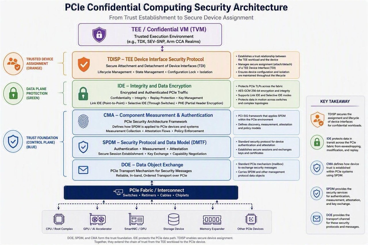

DOE, SPDM, and CMA establish the control-plane trust needed before a PCIe device can exchange protected traffic or be assigned to a confidential workload. Once a device has been authenticated and its security state validated, IDE protects data moving across the PCIe fabric while TDISP enables secure assignment of the device to a TEE.
Together, these technologies extend the chain of trust beyond processor execution and memory, allowing confidential workloads to communicate securely with PCIe-attached accelerators, storage devices, and network interfaces. Figure 1 illustrates how these capabilities build upon one another within the PCIe confidential computing architecture.
Figure 1: PCIe Confidential Computing Security Architecture (image generated by Microsoft Copilot)
