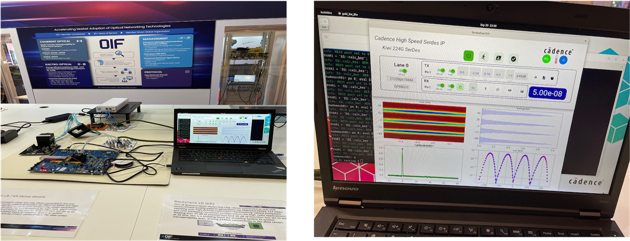

Real-world demonstrations at events like ECOC validate that high-speed IP, such as the Cadence 224G SerDes, perform as intended over both long and short reach with optimal signal integrity, low latency, and low power consumption. Cadence's live silicon demos of its 224G SerDes PHY IP highlighted its robustness, interoperability, and technical excellence in real-world scenarios featuring ecosystem vendors' cable and connector solutions.
At the OIF booth at ECOC, Cadence showcased CEI-224G-LR interoperability at a data rate of 212.5Gbps with a PRBS31Q data pattern, with total insertion loss exceeding 40dB (bump to bump) at Nyquist frequency. The long-reach 224G PHY demo setup featured a Multilane transmitter to Cadence receiver test chip silicon and cabled backplane channels using a Samtec SiFly HD connector with a 1m cable and a TE near-chip connector with backplane connectors and TE cables. The successful demo achieved a pre-FEC bit-error rate (BER) of 5E-08, highlighting the solution's error-free performance under demanding conditions.
At the Cadence booth, Cadence demonstrated serial link performance with a 45dB channel insertion loss (bump to bump) at a 212.5Gbps data rate and PRBS31Q data pattern, with a Cadence transmitter to receiver link setup. The achieved pre-FEC BER was 4E-08, further validating the robustness of the 224G PHY link setup. In a full solution with FEC, the system operates nearly error-free.
