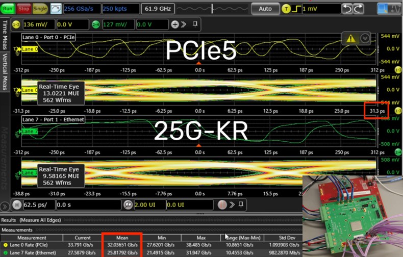

To explore the technology behind this multi-protocol flexibility, check out our demo video.
  • Arrow forward️ 1:40 – 2:30: Multi-Protocol PHY in Action
    This segment shows PCIe 5.0 and 25G Ethernet links running concurrently on a single PHY, demonstrating its ability to maintain signal integrity and consistent performance across protocols. This is a foundational capability for edge AI systems, such as autonomous platforms.
This demonstration underscores the interconnect agility required for next-gen edge AI, where multi-protocol integration isn't just beneficial, it's mission-critical.
