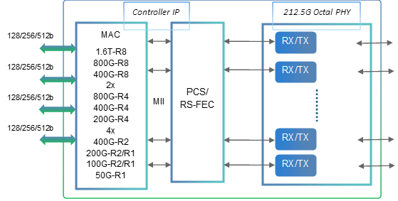

Cadence ESUN Controller IP
Building on its High-Speed Ethernet controller IP family, Cadence provides ESUN-ready controller IP for next-generation AI scale-up networking.
Key ESUN controller features:
  • Flexible multi-rate architecture supporting Ethernet speeds from 100G to 1.6T
  • ESUN link layer:
    • Per-port Priority Flow Control (PFC), LLR with configurable replay buffer size for lossless Ethernet, and CBFC supporting from 2 to 32 Virtual Channels
    • Compact ESUN and UFH Header framing supported
  • 1.6T multi-rate Ethernet MAC: Up to four independent 400G channels configurable for 1×1.6T, 2×800G, 4×400G, and 4×200G modes over 224G SerDes; up to four additional 200G channels may be added to the base configuration
  • Integrated RS-FEC:
    • Integrated RS-FEC options including Low Latency FEC/RS(272, 257+1)
    • Software selectable interleaving for minimum latency
  • Controller designed for minimum silicon area
Delivered as a complete, pre-verified controller, multi-controller, or integrated PHY package, Cadence ESUN controller IP helps reduce integration complexity, minimize implementation risk, and accelerate time-to-silicon for next-generation AI infrastructure SoCs. The controller combines ESUN link-layer capabilities, multi-rate Ethernet MAC, and integrated RS-FEC in a flexible architecture optimized for high performance, low latency, and efficient silicon utilization.
