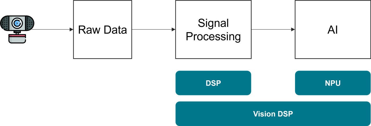

Vision DSPs offer a dedicated architecture capable of running all neural network layers (convolution, fully connected, pooling, normalization, and self-attention mechanisms crucial for Transformers) efficiently in a standalone manner. This minimizes power consumption and data movement compared to approaches that distribute NN execution across a DSP and a separate hardware accelerator. The Vision 331/341 series provides an integrated solution that is adept at both traditional vision/imaging pre/post-processing and AI inference on a single core.
The capacity to efficiently execute the intensive signal processing of iToF decoding alongside subsequent AI-driven enhancement and perception tasks on a unified, programmable, and power-efficient platform positions Tensilica Vision DSPs as a compelling choice for enabling advanced 3D sensing capabilities at the edge.

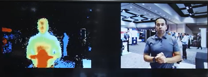

In the meantime, take a look at this video of the ToF decoding running on Vision DSP that was showcased at CES 2025 and most recently at CadenceLive Silicon Valley. There are tons of resources online if you want to dive deeper into the details of Vision DSPs.
