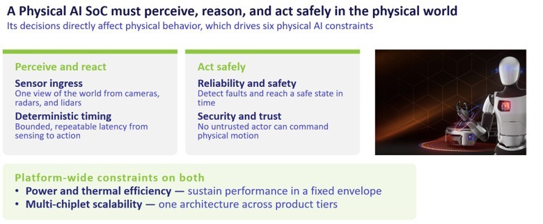

What Makes Physical AI Different
A physical AI system must perceive, reason, and act safely within real-world boundary conditions to address the determinism and criticality required in physical world interaction. Because decisions directly affect physical behavior, six constraints apply to every design.
Perceiving and Reacting
  • Sensor fusion: One-time-valid view of the environment from camera, radar, and lidar
  • Deterministic timing: Bounded, repeatable latency from sensing to action, worst case. and not just average
Acting Safely
  • Reliability and safety: Detect faults, report them, and reach a safe state within the deadline
  • Security and trust: No untrusted actor can command physical motion or alter safety behavior
Across the Whole Platform
  • Power and thermal efficiency: Sustain performance inside a fixed power envelope
  • Multi-chiplet scalability: One architecture that grows across product tiers and suppliers
Figure 1. Physical AI constraints

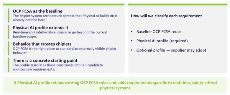

A Physical AI Profile for OCP FCSA
The workstream is proposed as a sub-project under OCP FCSA rather than as a standalone effort, for four reasons. FCSA already owns the chiplet system architecture baseline that physical AI builds on. Real-time and safety-critical concerns go beyond that baseline's current scope. OCP FCSA is the right place to standardize externally visible chiplet behavior. Finally, OCP FCSA delivers a concrete starting point to work from.
OCP FCSA rules will be retained, and requirement rules specific to physical AI, such as real-time, secure, reliable, and safety-critical physical systems are added. In practice, that means following the OCP FCSA chapter structure wherever possible, adopting the same rules-based writing model, and applying a strict anti-duplication discipline, especially where an OCP FCSA rule already satisfies a physical AI requirement, reference it rather than restate it. Where a proposed requirement conflicts with the baseline, the conflict is named explicitly and resolved through the OCP FCSA working group.
Each candidate is then classified by interoperability impact: baseline OCP FCSA reuse, required physical AI profile, optional profile, or architecture-specific guidance. Classifying candidates this way lets the group standardize what must interoperate across chiplets and leave the rest as guidance.
Figure 2. Driving standardization via OCP FCSA

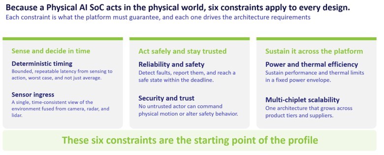

From Constraints to Architecture
An initial six constraints describe what a physical AI platform must guarantee.
Figure 3. The initial six physical AI platform constraints, starting point of the new profile
However, these initial six constraints are not directly specifiable. The bridging step maps each one to an architecture requirement area that can actually hold rules.

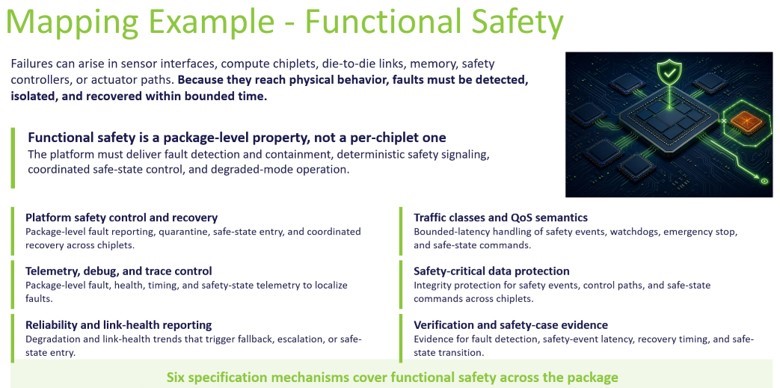

A Worked Example: Functional Safety
Failures can occur in sensor interfaces, compute chiplets, die-to-die links, memory, safety controllers, or actuator paths. Because they reach physical behavior, faults must be detected, isolated, and recovered within bounded safety response times.
Functional safety therefore, goes beyond the individual chiplet. The platform must provide fault detection and containment, deterministic safety signaling, coordinated safe-state control, degraded-mode operation, and evidence that the sensor-to-action path stays within its safety goals. That single architecture requirement decomposes into six specification mechanisms: platform safety control and recovery coordination; traffic classes and QoS semantics; telemetry, debug, and trace control; safety-critical data protection; reliability, degradation, and link-health reporting; and verification, compliance, and safety-case evidence.
Three of those six are shared mechanisms that also serve other constraints. That overlap is the argument for doing this work once, in a common baseline, rather than repeatedly across vendor stacks.
Figure 4. Functional safety example
