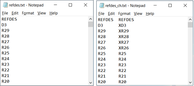

 Open refdes.txt in an ASCII text editor or Excel. Copy the first column and paste it into a second column. Specify the new REFDES values in the second column and save the file as refdes_ch.txt.
was/is reference designator list
