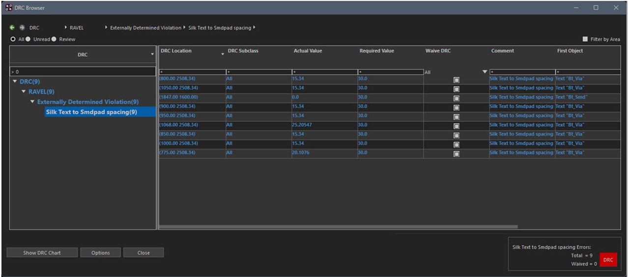

The first module provides an overview of the RAVEL verification system and the design rule checking (DRC) flow. It includes different ways for running RAVEL rules and reviewing DRCs using the DRC Browser, as illustrated in the following image:
Components of the RAVEL Verification System

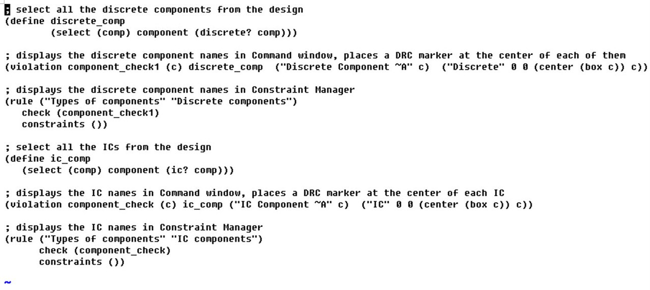

The second module of this course introduces RAVEL objects and their types. It discusses various built-in relations and how they correspond to objects in the PCB Editor and APD databases. Additionally, it covers how RAVEL combines objects to create tuples and relations, and it identifies how these relations correspond to objects in both PCB Editor and APD databases. The following snippet of RAVEL code displays both integrated circuit (IC) components and discrete components:
RAVEL code snippet
 DRC browser for RAVEL DRCs
