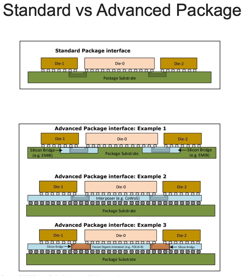

UCIe supports two types of interconnects. When connections embedded in the package substrate are used to connect the two dies, it is called the standard package and results in lower cost, lower connection density, and longer reach. This is also known as the 2D interconnect. Alternatively, an interposer or bridge can be placed between the active dies and package to give a layer of high-density routes, as shown in the image below, or a silicon bridge embedded in the package substrate. This is called an advanced package, which provides a much higher density of connections and lower power consumption, but higher cost and shorter reach. In both cases, UCIe supports a range of speeds, as well as a significantly better bit-error-rate (BER) than chip-to-chip interconnects.
Standard vs Advanced Packaging

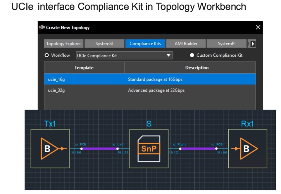

The SystemSI compliance kit supports both the standard and advanced package interfaces as well as the different supported speeds. Once the standard or advanced package template is selected, all the information for the BER and speed is available.
UCIe Interface Compliance Kit
This new UCIe kit includes the UCIe specification for v1.1, as well as templates for data rates of 16 and 32Gbps, generic IBIS-AMI models, a generic UCIe reference channel, voltage transfer function (VTF) calculations, and a compliance check report.

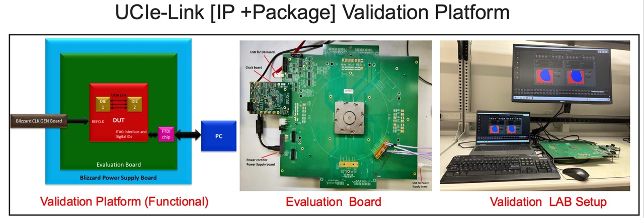

  • UCIe Link (IP and Package) Validation Platform
    • TX output to scope setup
    • 32G TX output eye
    • 32G low-swing performance on AB (7.4mm)

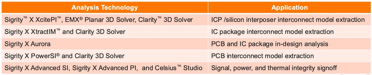

Cadence systems analysis technologies
