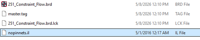

Method 1: Load a SKILL File from the Working Directory
The simplest approach is to place the SKILL file in the same directory as your board file.
  1. Copy the SKILL file into your working directory.
    The following image shows an example directory containing a sample board and a SKILL file 251_Constraint_Flow.brd and nopinnets.il.

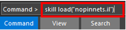

  2. Launch Allegro X PCB Editor.

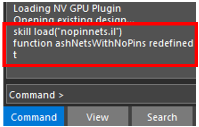

  3. Load the SKILL file.
    Enter the skill load("nopinnets.il") command in the Command window.
    If the script loads successfully, the command line displays t as the final entry.

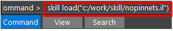

Method 2: Load a SKILL File Using a Full Path
If the SKILL file is stored outside the working directory, specify its complete path directly.
skill load("C:/work/skill/nopinnets.il")
This method is especially useful for centralized SKILL repositories and shared utility locations.

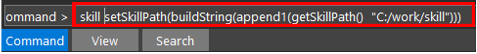

Method 3: Add a Custom SKILL Path
If you frequently use SKILL files from the same directory, you can add that location to the SKILL search path using the setSkillPath command. This command appends the specified directory to the existing SKILL path. Once added, SKILL files in that directory can be loaded without entering the full path each time.
For example, if you save your SKILL files in C:/work/skill directory, you can use the following command:
setSkillPath(buildString(append1(getSkillPath() "C:/work/skill")))
This approach is ideal when repeatedly testing or developing multiple SKILL utilities.

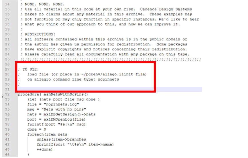

How to Identify the Command Used by a SKILL File
After loading a SKILL file, you need to know which command to enter in the PCB Editor command window to execute the utility.
A simple way to identify the command is to open the SKILL file in an ASCII text editor and review the developer comments.
Developers often include:
  • Single-line comments using semicolon (;)
  • Block comments using /* */

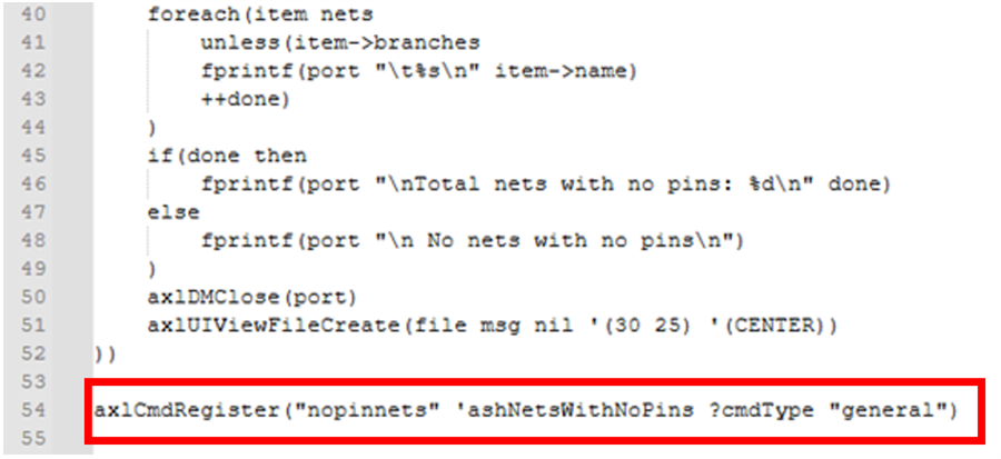

Another useful technique is to locate the axlCmdRegister function, which registers the command name associated with a SKILL script.
For example:
  • nopinnets is the command entered in PCB Editor.
  • ashNetsWithNoPins is the SKILL function being executed.
