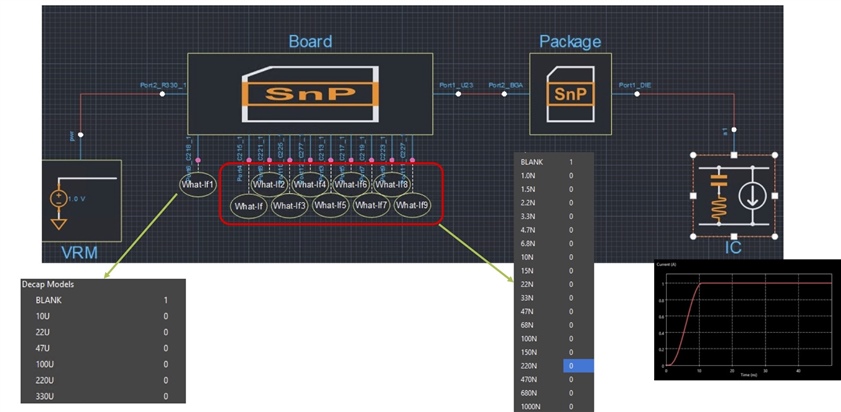

The EDI CON talk presents a test case highlights how SystemPI and Optimality work together to streamline PDN design. As a demonstration of the Optimality engine in the SystemPI flow, a test case was created to optimize the decap values of multiple decap positions using time-domain simulations. The objective function is to minimize the initial undershoot and the number of needed decaps simultaneously. The below image shows the test case setup.
Given a list of possible decap values, find the decap values that provides the lowest undershoot from a die current step of 1A. Simulation results showed a reduced number of needed decaps while exceeding the undershoot spec of 5% (50mV).

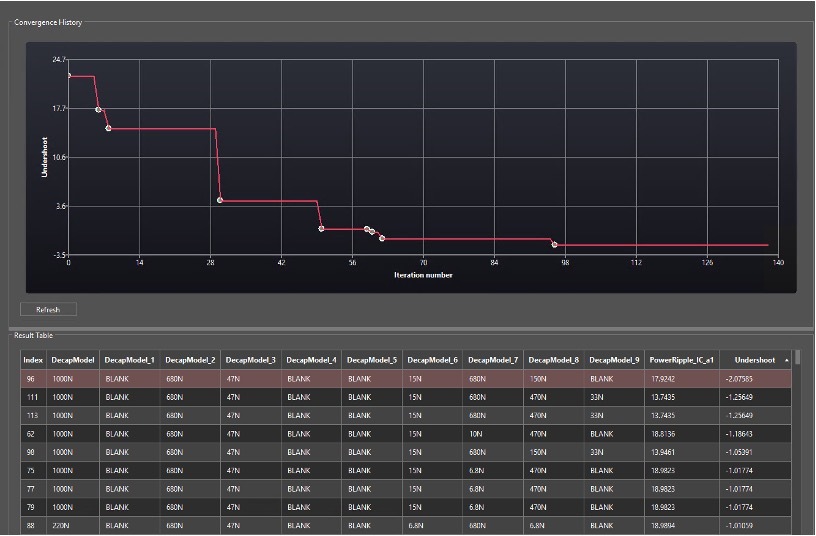

The plot below illustrates the simulation results. Each downward step represents a new simulation that produced a lower objective value than the previous best. While only the updated points are shown, intermediate simulations can be displayed if needed. The first ~57 simulations were run randomly to build a diverse sample space, which is known as the exploration phase. Around simulation 58, the algorithm began balancing exploration with exploitation, refining its search based on prior results. From that point, Optimality iteratively ran simulations, updated the model, and adjusted design parameters until either the maximum of 200 simulations was reached, or an optimal solution was found. In this case, the process concluded before reaching 140 simulations.

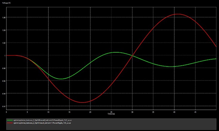

The next figure compares two scenarios: the red curve represents the worst-case condition with all decap positions left empty, while the green curve shows the optimized result.As you can see, the optimized design significantly reduces power ripple compared to the baseline. While our primary measurement focused on initial undershoot, the tool can easily be configured to target other metrics—such as minimizing ripple beyond the initial transient—depending on design goals.

The optimized result exceeded the 50mV undershoot spec while reducing the number of decaps by four. At simulation index 96, the power ripple was just under 18mV, with four blank decap positions, demonstrating both performance and cost savings. Achieving this result with fewer than 200 simulations out of over two trillion possible combinations highlights the efficiency and effectiveness of the Optimality engine.
