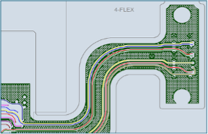

As data rates continue to scale into the multi-tens of gigabits per second, the tolerance for uncertainty in interconnect behavior has significantly diminished. At the same time, packaging and board-level technologies are evolving toward higher density, heterogeneous integration, and greater compliance with standards. These trends have driven widespread adoption of meshed reference planes, including cross-hatch ground planes in flexible and rigid-flex designs (Figure 1), and perforated planes with degassing holes in 3D-IC packages (Figure 2).

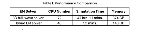

Conventional approaches to modeling meshed planes rely on 3D full-wave EM solvers. However, a single metal layer may contain thousands to millions of apertures, making direct simulation computationally expensive and often impractical for iterative design flows. Furthermore, SI and PI effects must often be evaluated simultaneously, further increasing model complexity. The article presents ML-based modeling approaches that efficiently characterize SI and PI behavior in systems with meshed planes.

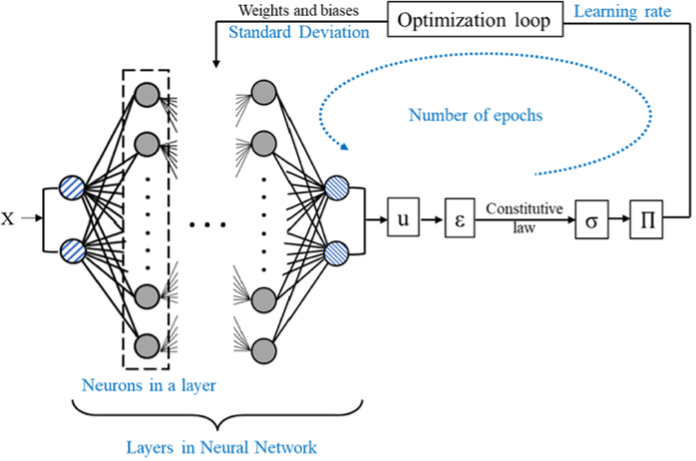

ANN Architecture and Hyperparameter Optimization
Artificial neural network (ANN) models are developed for pre-layout SI analysis of traces referenced to meshed ground planes. These models offer sufficient flexibility to approximate the nonlinear relationships between meshed-plane geometry and EM response. However, model performance is strongly influenced by hyperparameter selection, including hidden layer count, hidden dimension, learning rate, and training epochs.
Rather than relying on manual tuning or grid search, Gaussian process-based Bayesian optimization is employed to identify optimal ANN hyperparameters.

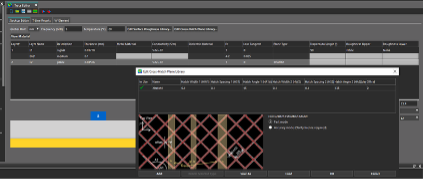

To address these challenges, ML models are being introduced as surrogate models for EM-based SI analysis. They focus on traces referenced to meshed ground planes, particularly cross-hatch structures commonly used in flexible and rigid-flex boards. The outputs of the model include per-unit-length inductance and capacitance, single-ended trace impedance, propagation delay, and velocity, differential and common-mode impedance for coupled traces, and differential delay and delay mismatch. These outputs directly support pre-layout SI analysis and constraint definition.
The methods proposed in the article demonstrate high accuracy compared with 3D full-wave EM simulations, while achieving orders-of-magnitude reduction in computation time. The advantages are:
