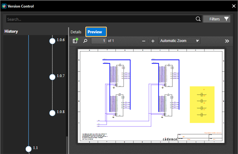

Navigate to File – Version Control to open the Version Control window. From here, you can:
  • View all saved versions.
  • Download and preview the PDF of any version.
  • Open or roll back to a previous version with a single click.

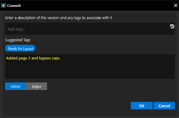

Check-In and Comments
A check‑in (commit) operation captures a complete, versioned snapshot of the design in the version control system, ensuring that each meaningful milestone is formally preserved. Encouraging the addition of clear, descriptive comments strengthens team collaboration and provides valuable historical context for future design decisions. Once committed, the design is securely stored on the pulse server (or the configured version control system), giving teams the ability to browse detailed version histories, compare changes over time, and roll back to earlier states whenever needed to maintain design integrity and workflow continuity.
When committing a design:
  • Use File – Commit to check in the updated project.
  • Add comments to describe the changes.
This is critical for team collaboration and audits, and even helps designers recall why certain changes were made in the past.

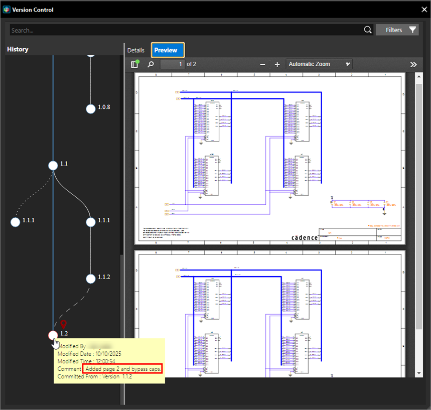

Rollback Functionality
Need to revert to a previous design state? Just select the required version and choose Open Version. This feature minimizes downtime caused by incorrect changes and prevents errors from propagating to the layout.
