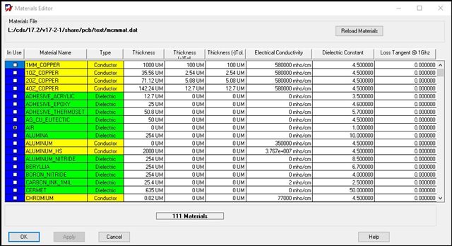

You can access the materials form from the Setup menu. In 17.2, this form was starting to show some age:
With its blue, yellow, and green areas, the form stands out. But, the information that it provides is limited. And, beyond that, finding a specific entry can be difficult. You can right-click the column headers to pick the column to sort on, but you cannot filter the entries by name or attributes (or see visually what the table is sorted on). Meaning, you will always see all entries and must find the one you are looking for in the list manually.

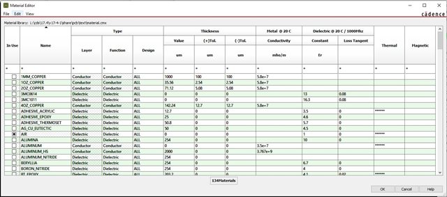

17.4 greatly simplifies this. You can now click on any column to sort on it. AND you can specify filters for each of the columns to trim down the list to find the item you’re looking for. The page updates dynamically as you type in any of the filters; you can watch the list get shorter with every additional character you type.
You can make the text in the form larger or smaller by clicking to activate the table. Then, with the Ctrl key pressed, scroll your mouse wheel in or out like you are zooming. The text will get larger or smaller, allowing you to see things with the ideal size for your monitor’s resolution and font scaling. Handy!
Columns for thermal and magnetic properties provide more data. Don’t skip over the Design column under the Type heading, either. If you are one of our many customers who design both PCB and Package substrates, the design column permits you to flag materials as being available for just board or just package designs. With this, selecting a material in the cross-section form will only show those materials that are appropriate for the type of layout you are working on.

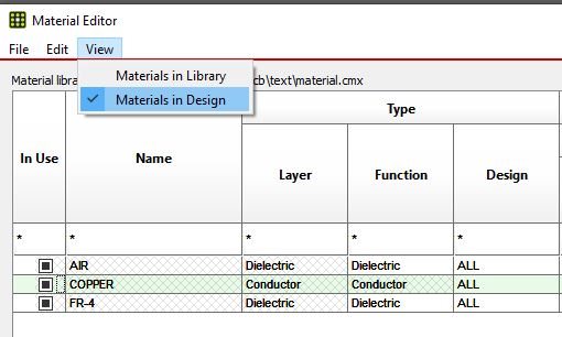

The View menu is the simplest. Here, you can change what is shown in the grid. Say you only want to see those materials that apply to the active drawing. The View menu’s where you want to go. As shown below, if I turn off the Materials in Library option and leave just Materials in Design, my table gets MUCH smaller (only three layers in this case!), and I can see quite simply all the materials that comprise this layout.
Note, however, that presently the materials listed as in use apply for the layer stack only. If you want this form to include such options as the materials used for bond wire profiles in the active design, maybe your die stack spacers, adhesive materials, or pillar / bump / BGA balls, let us know so we can make sure you see everything you need to in order to completely understand and describe your design.
