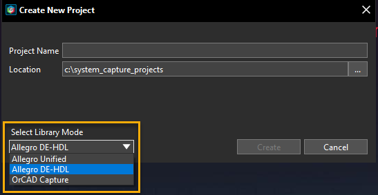

Choose the Library Mode at Project Creation
Allegro System Capture supports three formats for the parts libraries, Allegro® Unified, Design Entry HDL (DE-HDL), and OrCAD® Capture. When you create a project, you can pick the library format this project will use. This is set at the time of project creation and cannot be changed later.
This works a bit differently when multiple designers connect to a central Allegro® PulseTm server. There, the library format is decided by the library administrators.

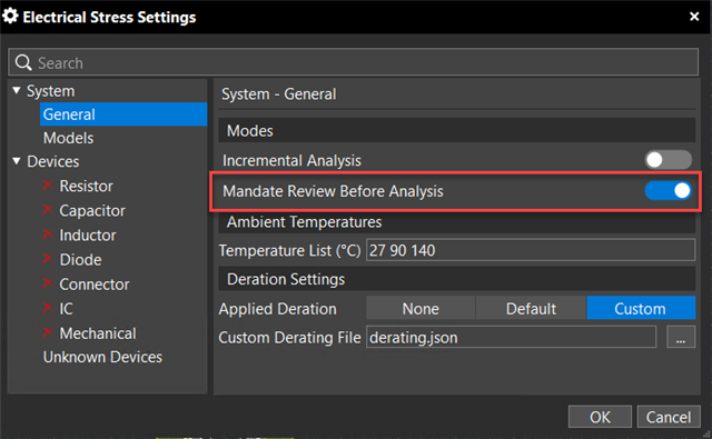

Another interesting new feature is the ability to enforce reviews before running audits. This option requires specific licenses. When activated, devices that have one or more parameters with default values are highlighted. You first need to check and confirm the default parameter values for the device and then run the analysis.
