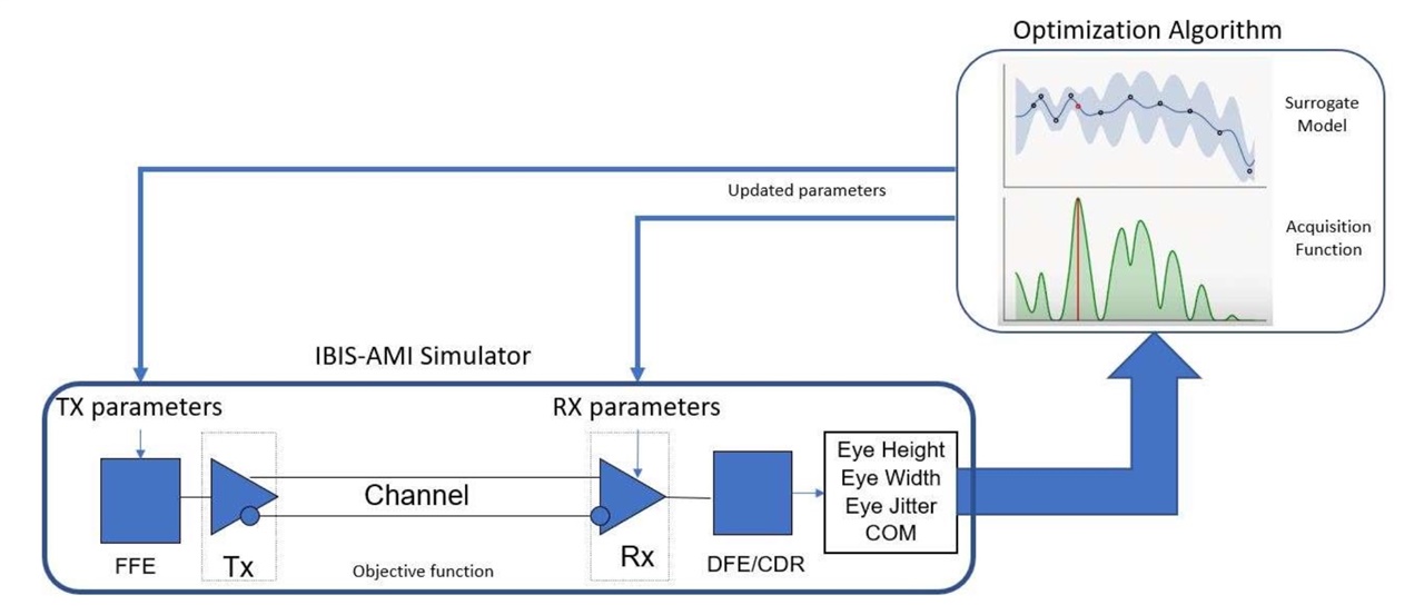

Machine Learning Optimization
The ML algorithm was applied to the optimization of AMI parameters in a serial link simulation. The results show that the algorithm was able to successfully find good results for three different channels. This method found a good set of parameters in fewer simulations than if a traditional manual method had been deployed, saving the use of limited human and compute resources. In most test cases tried, it was found that only 100 simulations were needed to find the best set of parameters.
 Optimization Algorithm
IBIS-AMI Model Generation
For this study, heavily parametrized IBIS-AMI models were needed to leverage the Sigrity ML optimization technology. A model based on the OIF-CEI-112G- LR standard was selected due to its large number of parameter combinations. Had the traditional manual method been used, there were a total of six different parameters that could be optimized between the RX and TX models, translating to 636,804 simulations for complete coverage of the solution space.

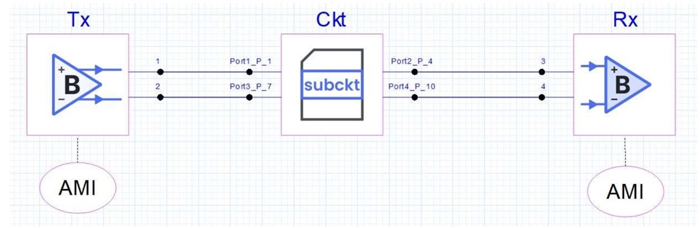

Simulation Setup
A testbench was built in an IBIS-AMI simulator, shown below. The simulation was run long enough to allow the decision feedback equalizer (DFE) to adapt to the incoming data (~70kbits), and to accumulate ~100kbits for making measurements. The simulation was run with 64 steps per user interface and a vertical resolution of 2048, allowing sufficient detail for taking accurate measurements.
 IBIS-AMI testbench

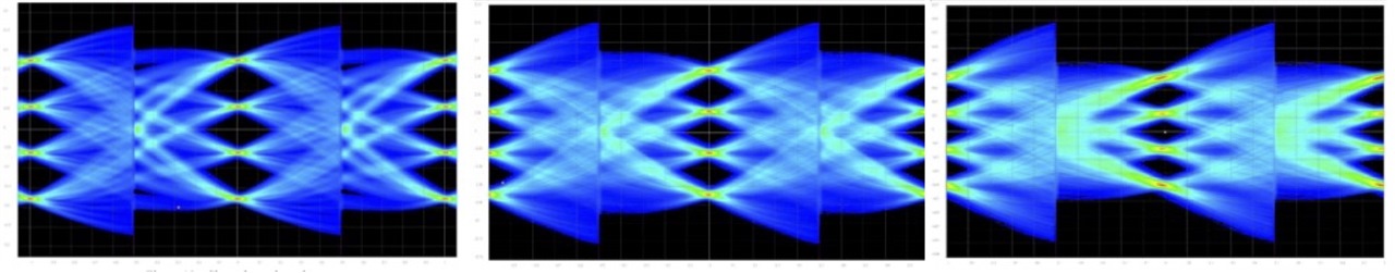

Simulation Results
The figure below shows the optimization convergence for three different channels: short channel (left), medium channel (center), and long channel (right).
  ML optimization results
It is clearly shown that the ML optimization found parameters that resulted in good open eye results at the RX.
