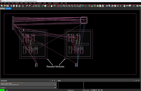

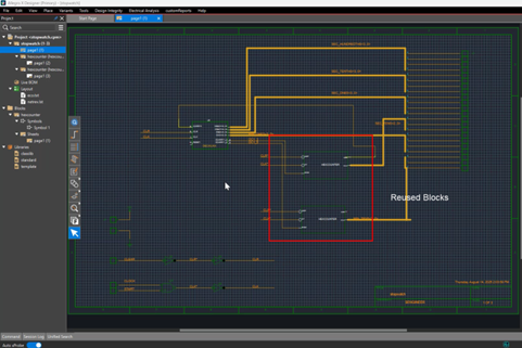

  1. Reuse in Other Designs
  • Add the block symbol to a new top-level schematic
  • Place the physical module in PCB Editor using the $MODULEPATH variable
