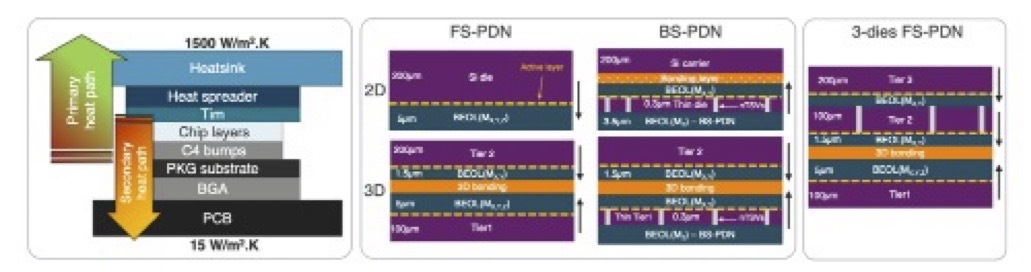

The impact of 3D integration versus 2D on the thermal profile in the package was compared. Figure 1 shows the complete package with cooling and PCB (left), chip layers for 2D and 2-dies 3D-IC with FS-PDN and BS-PDN (middle), and chip layers for 3-dies 3D-IC (right) (schematic only, not to scale).

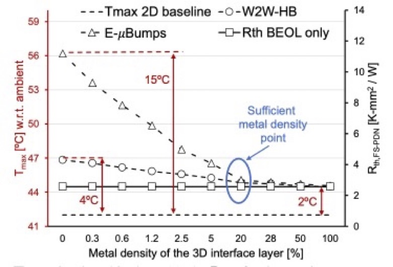

The paper describes the analysis of the impact of different 3D integration technology parameters, partitioning scenarios, 3D stacking options, and power delivery approaches on the temperature profile in the layer stack. Studies were performed on a 64-core SoC with L1 and L2 memories and power density like HPC applications. It was shown that at 20% of metal density (or more) in the 3D interface layer, the Tmax is dominated by the BEOL; hence, the choice of 3D interface technology (EμBumps or W2WHB) does not have a thermal impact. Figure 2 shows the Tmax in the chip layer(s) and Rth for increasing the amount of metal density in the 3D interface layer for EμBumps and W2WHB.
