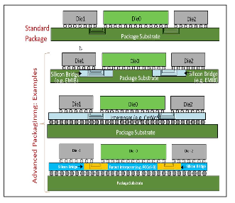

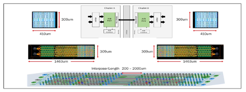

The Universal Chiplet Interconnect Express (UCIe) standard is important for the future of advanced packaging and semiconductor system design. UCIe Full Signal Integrity Analyis with Compliance Check for Heterogenous Integration, presented at the 2026 International Conference & Exhibition on Device Packaging (IMAPS) by Shawn Mills and Ken Willis of Cadence, explores the trends in the industry and overviews Cadence’s complete analysis solutions with UCIe standard compliance checking and verification.
Cadence UCIe Compliance Kit
The Cadence UCIe compliance kit uses a novel approach for signoff verification. This paper details the analysis solution and design architecture with various test cases from Cadence and its customers. The paper includes the following sections: details about the UCIe standard and its importance,  heterogeneous integration of the interposer, and lastly, the fine-grained simulations and analysis required to close the design.
