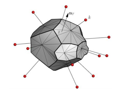

For high-resolution polyhedral meshes, each cell can have many neighbors. In implicit methods, those couplings are represented through large, sparse Jacobian matrices containing many off-diagonal matrix blocks, which can quickly consume GPU memory and bandwidth even when the processor has enough compute capability.

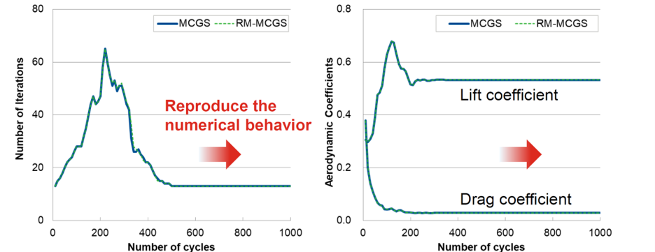

Memory efficiency is valuable only if accuracy is preserved. For performance evaluation of the transonic Common Research Model aircraft case, MCGS and RM-MCGS (scFAST) were compared using the HLLC flux, a less dissipative numerical flux suited to shock-wave analysis and high-speed flow applications. The results matched closely for both solvers, as shown in the figure below.
Comparing linear solver iteration count (left) and evolution of aerodynamic coefficients (right) using both MCGS and RM-MCGS solver

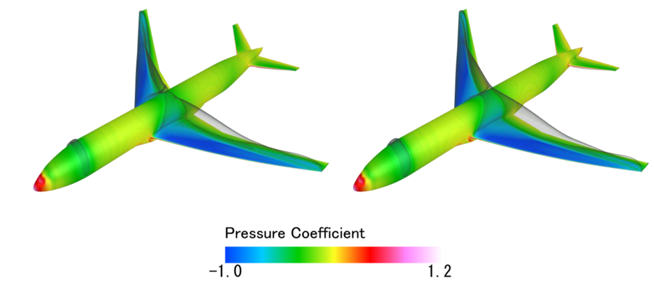

Compared with the simpler but more dissipative Rusanov flux, HLLC better preserves contact and shear waves, making it useful when shock resolution, pressure distribution, and wave structure matter. The key question was whether combining HLLC with RM-MCGS retains accuracy without eroding performance.
The image above illustrates isosurfaces of surface pressure distributions for (i) Rusanov flux (left), (ii) HLLC flux (right); The graph below compares the mid-span pressure coefficient distribution obtained using scFLOW and scFAST, showing close agreement between the two solvers and good correlation with the experimental results

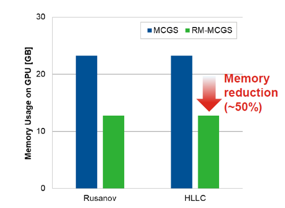

The results were encouraging; RM-MCGS reproduced the numerical behavior of the original MCGS method, while HLLC improved pressure distribution and shock-capturing accuracy when compared with Rusanov. From the figure below, it is clear that RM-MCGS reduces memory usage on NVIDIA GPUs by around 50% for both Rusanov and HLLC fluxes compared to MCGS.

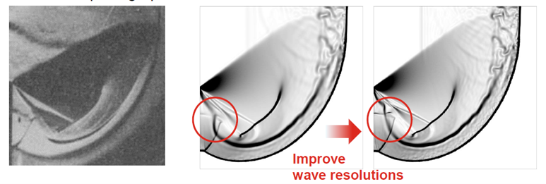

A separate shock-wave diffraction example also showed improved wave resolution with HLLC. Together, these cases demonstrate that the reduced-memory approach is not only a capacity optimization; it can also support practical aerospace simulations in which shock structures and wave interactions are central to the engineering question.
Comparing the wave resolution in (i) Schlieren photograph (Bazhenova et al., 1984), (ii) Rusanov flux, (iii) HLLC flux

The RM-MCGS method achieves approximately 50 percent reduction in GPU memory usage. For engineering teams, this is a meaningful shift. Instead of treating GPU capacity as the limiting factor, users can now refine key regions, or support more demanding physics within the same hardware envelope. This is especially relevant as CFD users move toward more detailed models and broader design exploration across aerospace, automotive, turbomachinery, and thermal applications.
