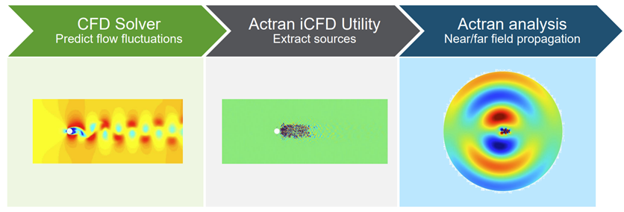

In a typical Cradle CFD–Actran workflow, scFLOW provides the unsteady flow field, and Actran focuses on the acoustic side of the problem. This separation is especially useful when the flow creates the noise but the acoustic field does not significantly alter the flow, which is often the case in practical aeroacoustic design studies.
From CFD Results to Acoustic Sources
The workflow begins with source extraction. Aeroacoustic sources are computed from the computational fluid dynamics (CFD) mesh, mapped and integrated onto an acoustic mesh, and then transformed from the time domain to the frequency domain through a Fourier transform when frequency-domain propagation is required. The resulting source terms are typically Lighthill or Möhring sources, which are then propagated in Actran.
This division of responsibility is important. The CFD model can concentrate resolution where the unsteady flow generates noise, while Actran can focus on how that noise travels through the surrounding medium. If the propagation setup changes, for example, because the receiver position, acoustic treatment, or surrounding geometry changes, engineers can often reuse the CFD-derived sources instead of restarting the full flow simulation.

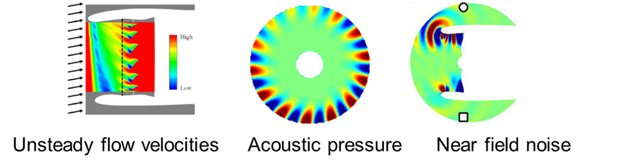

The right Actran propagation technology depends on the characteristics of the fluid medium, particularly the presence of mean flow, flow heterogeneities, obstacles, boundary layers, and ducts. Standard Actran finite element technology is well suited when only a mean flow is considered and when heterogeneities remain smooth, even in the presence of obstacles. Actran DGM is better adapted to complex flow patterns, such as rotational mean flow, strong heterogeneities, obstacles, and boundary layers. Actran TM is dedicated to high-order mode propagation in ducts, especially where high flow speeds and heterogeneities are present.

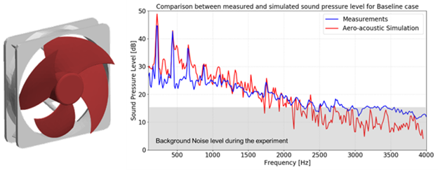

For fan noise in a free field, with no flow or fluid heterogeneity in the propagation medium, the Lighthill approach can be used with inputs from an unsteady scFLOW run. This workflow can capture both tonal and broadband noise, making it useful for evaluating the acoustic signature of rotating machinery such as fans.

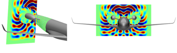

When the propagation medium becomes more complex, Actran DGM is the stronger choice. One example is open-rotor engine noise around an aircraft fuselage, where acoustic waves interact with the aircraft environment and refraction effects become visible near the fuselage boundary layer. Jet-engine exhaust noise is even more demanding because the jet introduces high-temperature gradients and complex flow dynamics that can strongly refract acoustic waves.

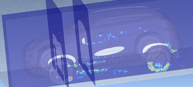

For vehicle wind noise, Actran SNGR offers a faster route because it can work from simplified steady-state RANS CFD runs, making large-object investigations more affordable.
A full-vehicle wind-noise study, for example, can reveal how aerodynamic noise varies across the vehicle, including higher levels around the rear wheel than the front wheel in representative operating conditions such as 100 km/h. The same approach can also support high-frequency side-mirror noise studies, where mean-flow results can be used to predict acoustic behavior with strong experimental correlation while reducing CFD runtime by an order of magnitude.
