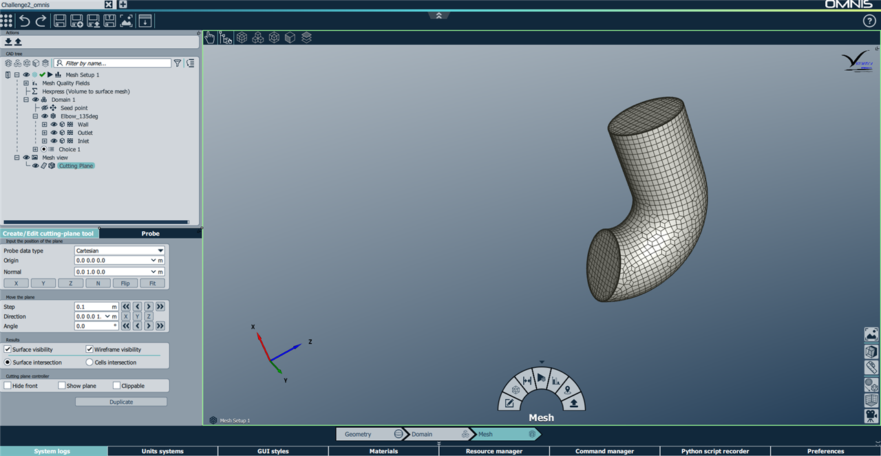

Hi all,
I have the problem, that there is no simulation context I can select to simulate the projetct.
How could this happen and how can I fix this problem to complete the simulation of the 2nd challenge?
Tank you very much!
Best regards
Max

    Hi MaxiWei,
    this happens, if you open the template Hexpress instead of the template Open. There are 2 ways to fix it:
    • You start from scratch using the Open template.
    • You add the other CFD work flow steps to you current template. For this you need to do the steps below:
      1. Go to GUI Styles in the bottom menu.
      2. Duplicate it your preffered GUI style. Rename it, if you want.
      3. Activate and select the new created GUI sytel.
      4. Actiavte the option advanced widgets in the section GUI behaviour. Now you have a search bar in the top right of the GUI.
      5. Use this earch bar to activate the Simulation context as well as the Result analysis context.
    Best regards
    Manuel
