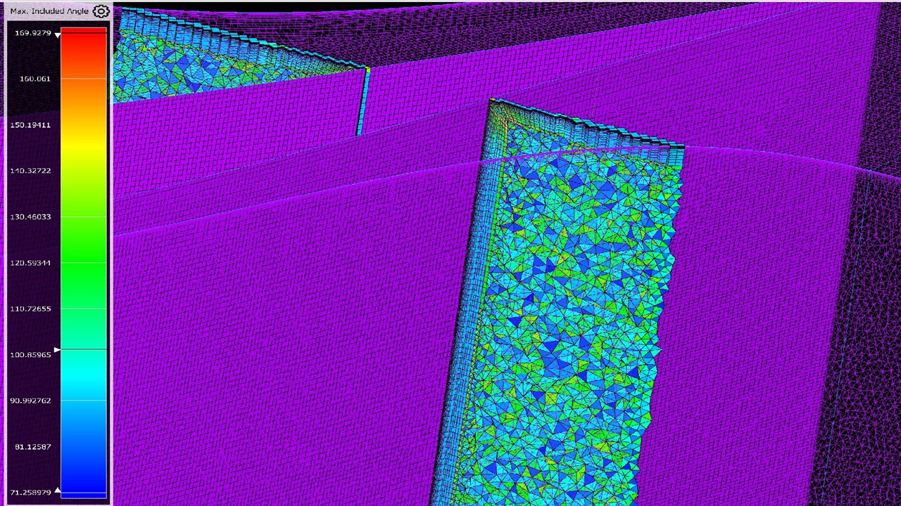

Hello everyone,
My problem is creating a block between the inflation layers. The reason for the failing of the block creation are the domains on the outer surface of the vane-block, which were created during the extrusion of the vane in rectangular z-direction. The problem here is that these domains of the vane are too long and go directly into the wall layers (problematic domains marked in white). That's why it's not possible to create the block in the empty space between the inflation layers of the walls and the vane.
My question: is it possible to shorten the domains that they fit in the space between the two wall layers and they keep the same height so that there is no gap between the block I want to create and the vane block.
I’ve already tried to create the domains manually by creating connectors with the length of the distance between the two wall layers. This allowed me to create a block, but there was a gap between the created block and the block of the vane. The reason for the gap is that the manually created domain was not exactly on the outer surface of the vane-block.
I hope you could follow my explanations
Thanks for your help

    I can understand that you have tried creating domains via extrusion and that you have also created them manually. From those domains, you were able to assemble the desired block(s) but there were gaps with the existent block. Unfortunately, it is a bit hard to understand the entire mesh from a few images with different orientations.
    In order to offer the best possible recommendation, I would need to see the actual Fidelity Pointwise file with the grid to better understand what is going on. Would this be possible? Keep in mind that this is a public forum.
    Please note that you could use, for example, a Path extrusion in order to have more control over where the extrusion starts, stops, and what kind of grid point distribution the final domain will have. You should also be able to manually create domains that fit exactly the space you need them to fit (via the precise definition of the bounding connectors). That being said, which approach is best would depend on the particulars of your grid.

    Thanks for your reply.
    The model is divided into 3 sections (inlet, outlet and vane). The aim is to have inflation layers around the vane and inflation layers from the shroud and the hub (wall layers) that extrude into the body.  The empty spaces should then be filled with blocks and initialized. Furthermore, the case should be solved with mainly quad cells.

    My mesh creation process:
    -     Importing the CAD model and assemble the two vane quilts into a single quilt
    -    Create connectors on database entities
    -    Add a 2-point connector at the top and bottom of the vane
    -    Manually create the vane domains
    -    Extrude normal to the vane domains
    -    Assemble special domains for the for the walls (shroud and hub)
    -    Extrude the wall domains normal
    -    Manually create the domains for the rest of the surfaces
    -    Create a block for the inlet- and the outlet-section
    I tried your advice with the automatic surface mesh but the leading edge has big holes
    I also tried to create the mesh with T-Rex but I cannot find a way to create the mesh with mainly hexahedra cells. Is there a way to create the mesh with T-Rex and with hexahedra inside?
    Thank you very much for your help

    • The important thing is to ensure that the entire geometry is assembled into a single watertight database model (i.e., no gaps). Once this is done, you will need to assemble the quilts as needed to define the needed meshing regions. Note that the vein needs to be assembled into two separate quilts to nicely define the leading edge where a connector will be created. In order to better understand the Fidelity Pointwise meshing process, I would recommend reviewing he following videos:
      • Basic Concepts: https://youtu.be/7ynTrsuG80I?si=cwYjHwZ7-R-SGu7Z
      •  Automatic Surface Mesh: https://youtu.be/VmAYwRbChMk?si=0tPWKHdTjiLANjJf
      • Automatic Volume Mesh: https://youtu.be/EU1Cb2KeK-U?si=EjlmSo6aslowAJ6C
    • If the leading edge is not meshed correctly, is likely due to the fact that the entire vein is assembled into a single quilt; as indicated, you will need two quilts: one on the pressure side and one on the suction side. Please take a look at the videos above for a nice example.
    • If the surface grid is quad dominant (i.e., triangles and quads), T-Rex will create as many hexahedral cells as possible. In addition, you can use the Voxel algorithm to place cartesian cells in the isotropic section of the volume grid (seen in the third video above).
    I have uploaded a new file called Linear_Periodic_Case_Con_PWI.pw with the final mesh I obtained using the connectors that you have manually created (note that no quilting was done!). You can see the hexahedral cells in the boundary layer. In this case, I used the Delaunay algorithm to populate the isotropic regions but, as indicated, you can change this to the Voxel algorithm if needed.
    As indicated, the manual procedure you are following is not invalid; you will likely get to a valid good mesh. However, it is a more time consuming way of getting to the final result. What I am trying to show you is a faster way to obtain the mesh you are looking for.
