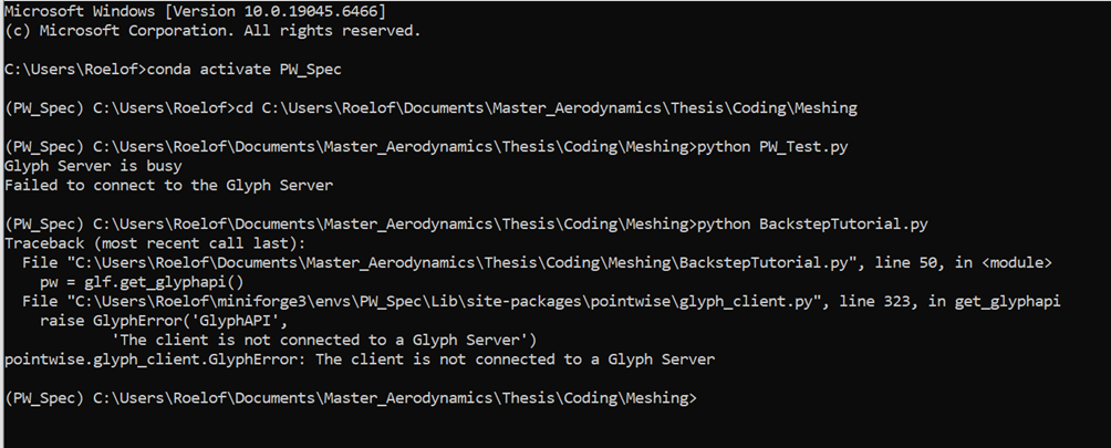

Hi All,
For a project I am looking to implement an automated meshing pipeline using the python API. I am running into issues with the stability of the connection to my localhost.
The Pointwise GUI is running as instructed (active glyph server with default port 2807). The license is also correctly reserved as I can use the GUI as intended.
The issue I am encountering is that my test scripts connect to Pointwise unreliably. For example, I ran the provide backstep python example program as provided on github (https://github.com/pointwise/GlyphClientPython/blob/master/examples/BackstepTutorial.py). It worked as expected last evening, but this morning I get the attached error message in my console:
Both the test code and the provided Backstep Tutorial have ran without issue on my machine. In quick succession as well and multiple times. When the error occurs, I get the response that the server is busy. Note that I have tried restarting my PC, it does not help.
Have any of you encountered this problem before, and how was it resolved? Is there a way to check and terminate active server connections in the pointwise GUI? Any other tips or tricks?
See also the exact code I use attached. The extension is .txt, as .py is not allowed on this forum. Note that the test program is less then 10 lines of code.
Thanks in advance for your assistence,
Kind regards, Roelof Fennema
Fullscreen PW_Test.txt Download

    Hi Roelof, Thank you very much for submitting your question. The error you received usually means that Fidelity Pointwise is busy with another task when a script is trying to be run. Note that I…
  • Claudio M Pita
    +1 Claudio M Pita 3 months ago
    Hi Roelof,
    Note that I was able to run your test script multiple times without issues after opening the GUI and setting the Glyph Server to Active. Now, if I try to use any other task in the GUI and then I attempt to run the script, I receive the exact message you posted (which is expected).
    As a test, please do the following:
    1. Launch Fidelity Pointwise
    2. Script, Glyph Server
    3. Listen Mode: Active
    4. Network Port: 2807
    5. Close
    6. Run the test Python script and it should run as expected.
    7. Back in the Pointwise GUI, Create, Notes (or open any other panel for that matter)
    8. Try to run the test Python script once again and note that you will receive the posted error.
    I hope this clarifies things,
    Best regards,
    Claudio M. Pita
  • RF20260309933
    0 RF20260309933 3 months ago in reply to Claudio M Pita
    Hello Claudio,
    Thank you for your answer. I have resolved the issue now. The problem was that I did not perform step 5 in your list, and instead left the Glyph Server tab open. If I open any other tab, the server will be busy (as you described).
