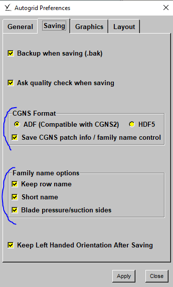

I am trying to export the generated mesh in OMNIS as it was possible in AutoGrid5 (NUMECA), but there isn't an option to keep the patch info/ family name controls as it was in the older version. Does anyone know where to find a similar option? I've attached the options menu from Autogrid5.

    Hi, In Omnis and Fidelity those options are not yet available. You can export the Fidelity Autogrid setup to legacy Autogrid however, or script the full process for having these steps repeated automatically…
