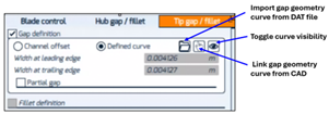

    This information will guide you on how to add and define a tip gap in the Fidelity Turbomachinery application. A tip-gap is a critical feature in turbomachinery design, and accurately modeling it is essential for precise simulations.
     To add a gap, follow these steps:
     In the Geometry context, select the blade entity in the left tree.
    1. Open the Hub gap/fillet or Tip gap/fillet tab in the properties panel.
    2. Activate Gap definition. Note that when a gap is added, the Fillet definition is blocked, except for partial fillets.
     There are two ways to define the gap geometry:
     Method 1: Importing a Defined Curve
     Click on the Import gap geometry curve from DAT file icon or Link gap geometry curve from CAD icon.
    1. Select a curve data ".dat" file or link curve(s) in the geometry view.
    2. If the import or link is successful, a message will appear indicating "Curve imported successfully" or "Curve linked successfully".
    3. The Defined curve option is automatically selected.
    4. The Width at leading/trailing edge values are updated accordingly.
    5. Use the Toggle curve visibility icon to preview the gap curve in the meridional view.
     Important Note: The imported or linked curve must not intersect any control lines defined outside the blade.
    Method 2: Channel Offset
     Select the Channel offset option.
    1. Specify the Width at leading edge and the Width at the railing edge to determine the size of the gap at the leading and trailing edge of the blade.
    2. The gap curve is constructed as a linear offset of the hub (or the shroud) based on the specified values.
    3. Use the Toggle curve visibility icon to preview the gap curve in the meridional view.
     By following these steps, you can accurately add and define a gap geometry in the Turbomachinery application, enabling you to perform precise simulations and optimize your turbomachinery design.
