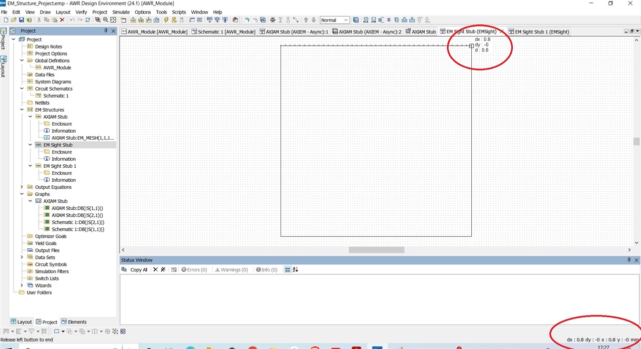

 I wanted to use EM Sight Simulator in AWR MWO. Once I choose the EM Sight Simulator from EM Structure option. We get square box with X - Dimension 0.8 mm and Y- Dimension 0.8 mm. I want to fit into my EM Axiam layout into EM Sight Simulator which has X- Dimension 15 mm and Y - Dimension 7 mm. EM Sight Simulator Square looks small(0.8x 0.8 mm) in front of EM Axiam Layout( 15mmx 7mm).
I tried all options to change X and Y Dimensions to 30x 30 mm from 0.8 x0.8 mm, then I can fit easily EM Axiam Layout 15x 7 mm into 30x 30mm. But I could not change from 08 x 0.8 mm to 30x30 mm. Someone can give suggestion to change from 0.8x0.8 mm to 30 x 30 mm.

    Double click on Enclosure and update X_Dim/ Y_Dim values.

    Even if you change X_Div = 1000 um, Y_Div = 1000 um, Grid_X =10 um and Grid_Y = 10 um, I am not getting EM Sight Simulator results.

    Not sure but there can be other reasons as well to complete the simulation and get the results.  I suggest for this you can contact customer support (submit a support case after logging in) with the project - that way an Application Engineer in team can look at this together with you.
