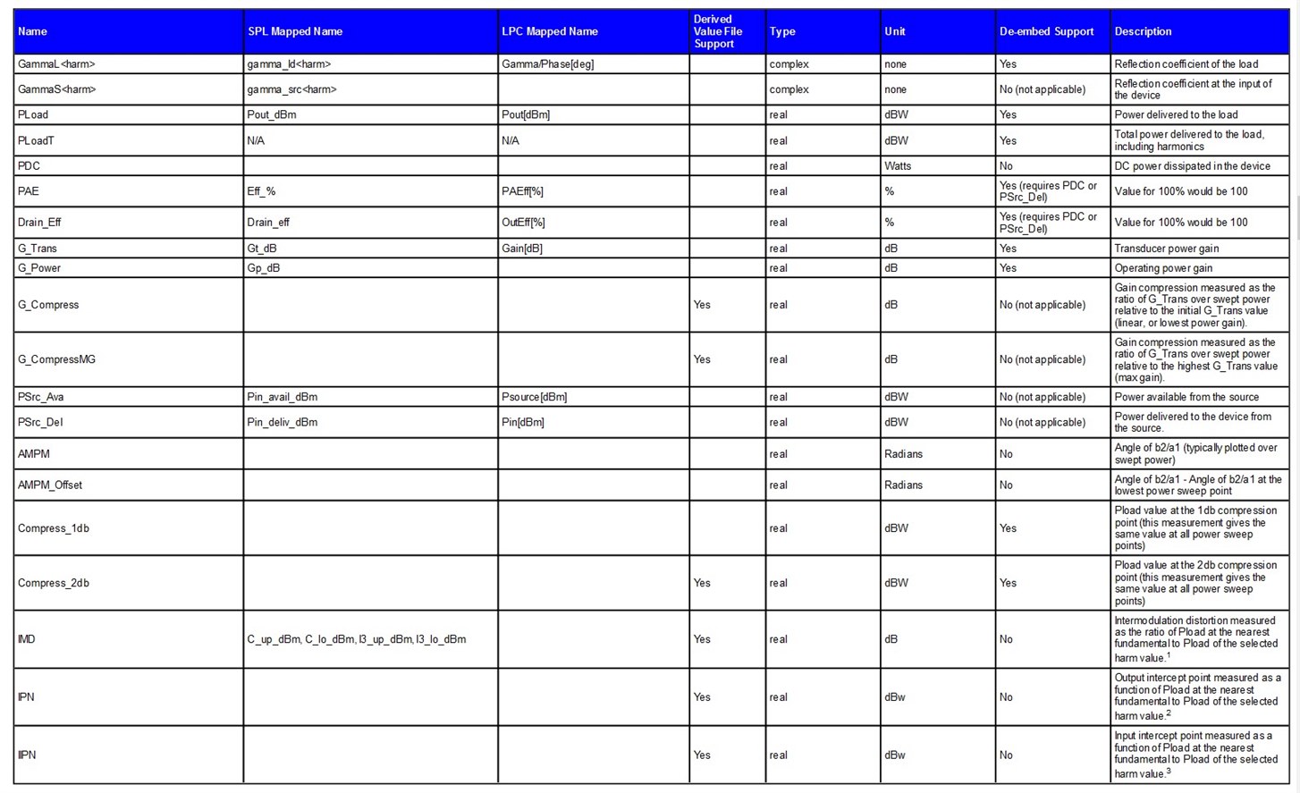

Hello everyone,
I have an extremely simple question. In a load pull analysis, one of the calculated values is Pload. Is this the power dissipated by the load, or the power delivered by the transistor to the load?
Thank you very much for your attention.
  • CurtisAWR
    0 CurtisAWR over 2 years ago
    Pload is the power delivered to the load.  I am attaching a table showing the calculated values that are automatically computed from the A/B wave format, available for use in this format.  Hopefully, this helps.
