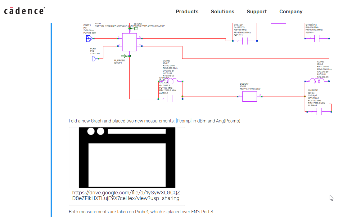

I've been working a few months with AWR and I am currently trying to make some simulations with Analyst on an Antenna design with an EM structure of 6 ports and a non-linear layout that is the excitation subcircuit for the 6 ports. The final structure is a combination of both structures:
However, the next step in the project is to measure the power signal in the 6 ports of the EM structure:
I would like to measure using probes the Power signal in the 6 ports of the EM structure in order to be able to change the Port Properties for the EM structure and set up the excitation for all 6 ports of a duplicate EM structure. Then, I could calculate and export the Antenna Radiation  Patterns with the Output File Menu's option AntPat_E, obtaining the radiation patterns of the EM structure excited by the subcircuit.
So, I would like to measure Power (dBm) in all 6 ports and its Phase (deg).

    If I understand your question correctly, you should be able to measure the power (phase and angle) at any of those six ports of the EM subcircuit, either by moving (or duplicating) the M_PROBE you have there, or by selecting the nodes themselves (without needing the M_PROBE element).
    Note that to obtain nonlinear measurements such as the power at a node, you will need an excitation for that circuit that provides some kind of power level as an input.  The PORT elements that you have there now are strictly linear, and you will need to change one of them to an element such as PORT1 (Port with 1-Tone HB Source) in order to accomplish this.

    I made a new schematic where I use now a Port with 1-Tone HB Source and I added another Probe.
    I did a new Graph and placed two new measurements: |Pcomp| in dBm and Ang(Pcomp)
    Both measurements are taken on Probe1, which is placed over EM's Port 3.
    Also, I duplicated this 2 measurements with probe 2, placed on Port 6 in order to compare the measurements.

  • CurtisAWR
    +1 CurtisAWR over 1 year ago in reply to Pablo Soto
    Hi Pablo,
    Your Pcomp measurement has the Harmonic Index set to 0, which is going to give you the power at that probe at DC.  I think it's likely the case you would want to change that value to 1, so you can get the power in the first harmonic (which is the fundamental frequency at which you are exciting the circuit).
    For more information on that measurement, you can click the Meas. Help button at the bottom right of the Modify Measurement dialog you've shown.  It should open up the Help page for that measurement.
